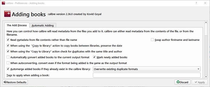

You can also drag and drop onto the wrong Book. That assumes you know what you have (bypasses extract/decode the metadata)
Add books has a safety (of sort) setting (see image)
Tweaks also has settings if you use the Copy To Library feature

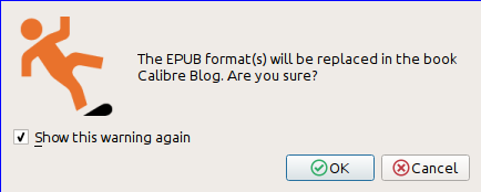

Umm there is already a confirmation popup when you use Add Books->Add files to selected book records or drag and drop onto the book details panel. Perhaps you disabled it? If so, go to Preferences->Behavior->Reset disabled confirmation dialogs.
