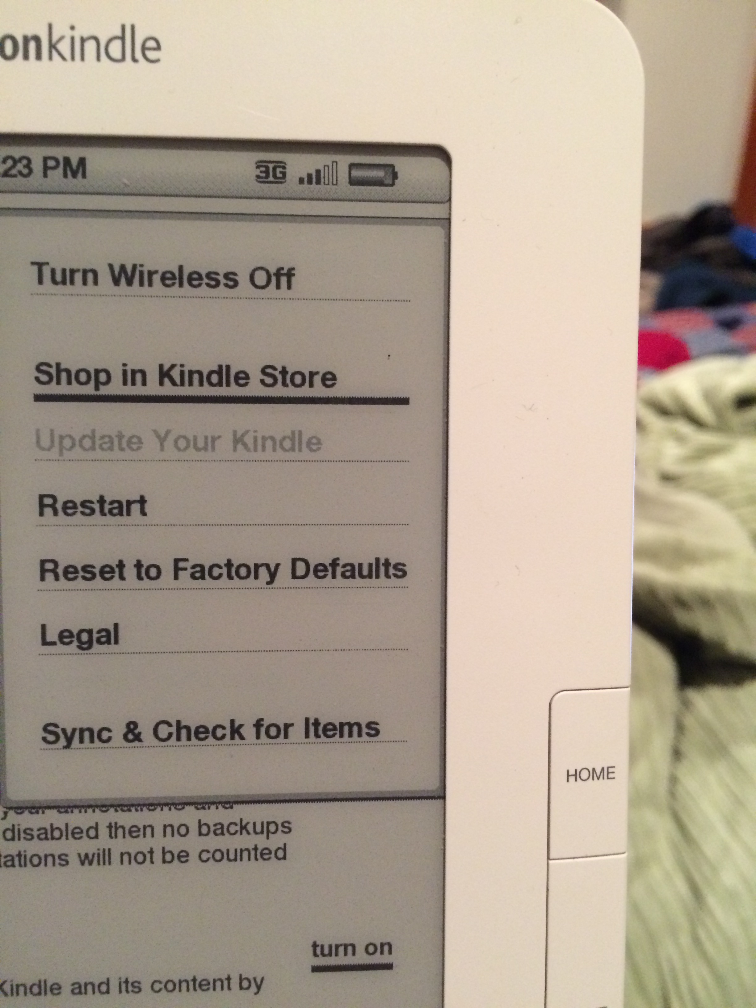

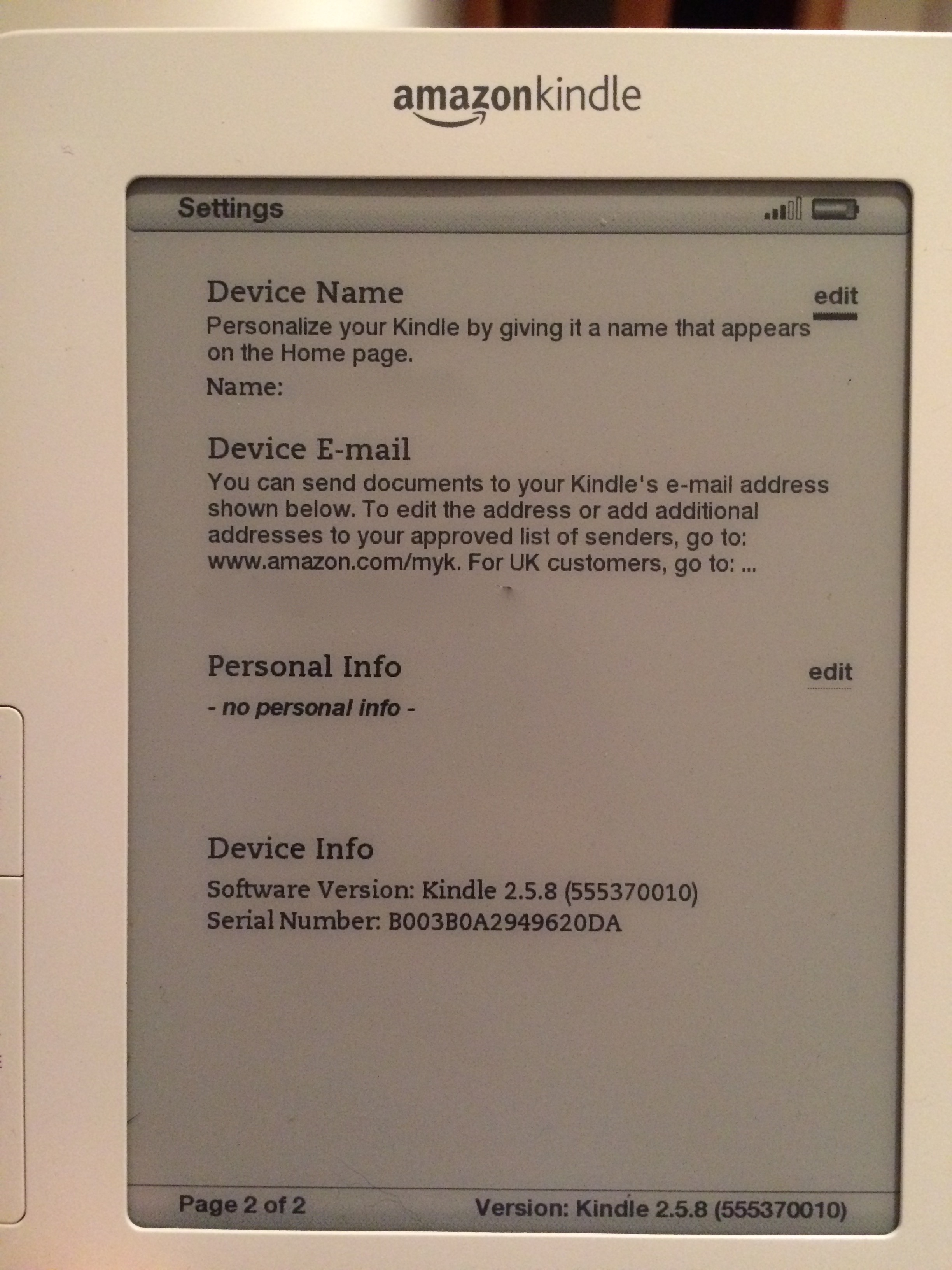

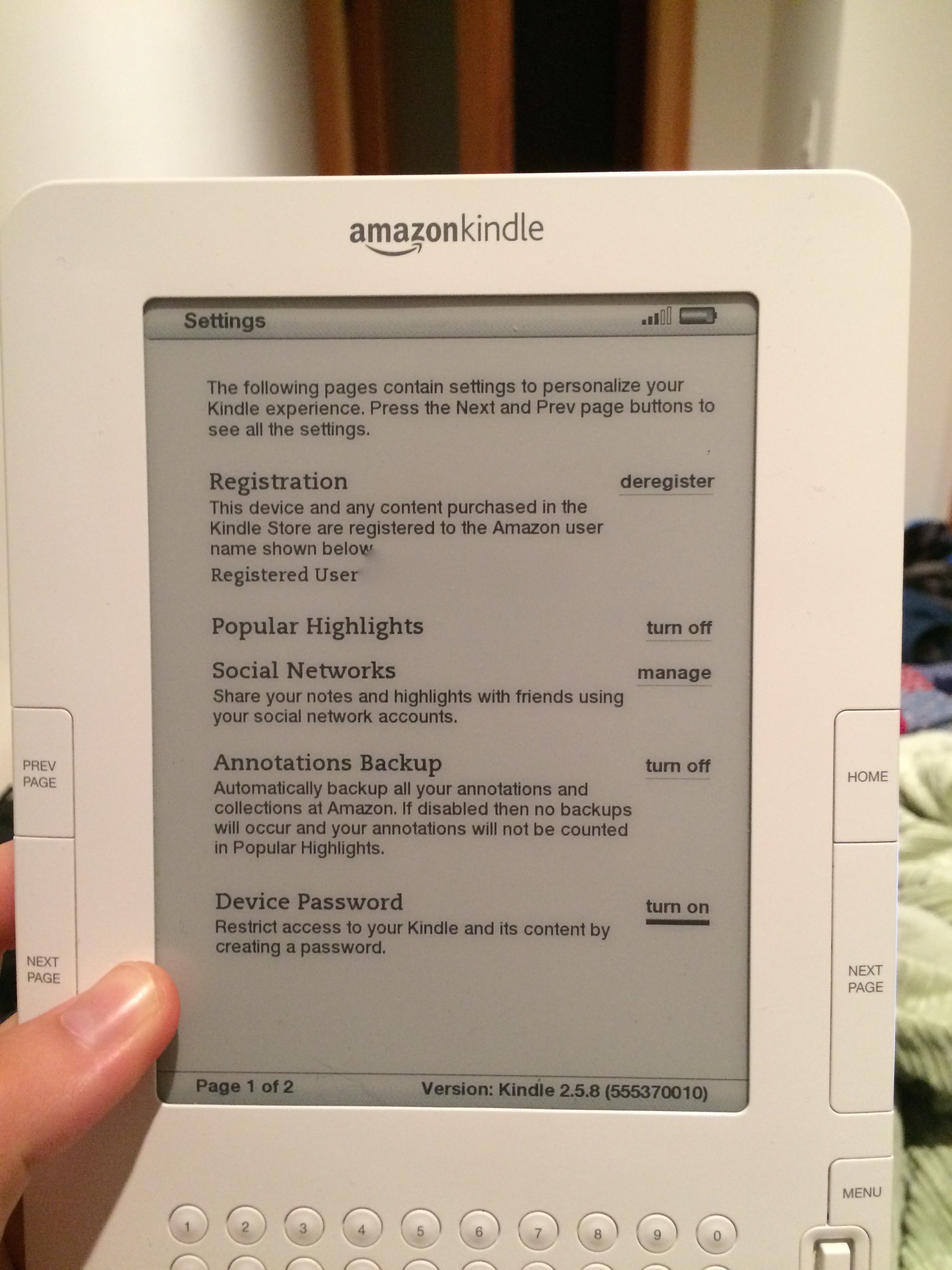

I don't believe there is an option to switch a 3G k2 to wifi. I attached pictures of all the settings screens (doctored to remove personal information).
USBNetworking is already installed and working great. ssh doesn't work for some reason (requires a password I don't know) but telnet logs right in. I also have KUAL and the screensaver hack to change the screensaver to book covers.
