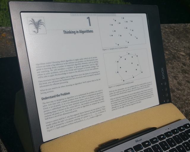

I have always used Ivan Ivanenko's "PDF Reader", and very happily so. His product has been recently rebranded "Lirbi Book Reader and PDF".
But it did not seem to have a "double page" mode, so today I tested "ezPDF Reader": VERY remarkable.
To encomiate the quality: my only trouble with Ivanenko's one is that the auto-trim margins may sometimes enlarge the cropped page without re-rendering, resulting in a jagged image. So, I normally pre-crop my PDF files using Briss. But Briss does not always work. In the video that will follow, I show a PDF file that Briss could not crop but that ezPDF did crop through a full interface - it worked on the tablet what could not on the desktop!
The speed is, in relative terms, lightning fast.
Please find a video, just uploaded, at https://youtu.be/OLBRi7qFRKI
(But do test - well not the OP, who is deciding - Ivan Ivanenko's)
Old 05-20-2017, 04:00 PM   #8
mdp
Posts: 1,481
Karma: 9010563
Join Date: Jul 2013
[proof of concept]
Old 05-21-2017, 06:25 AM   #9
mdp
Posts: 1,481
Karma: 9010563
Join Date: Jul 2013
The "Raspberry Pi Cookbook, 2nd Edition" from Simon Monk (O'Reilly 2016) weighs 129 MB. It is a proper "vector and raster" PDF (mentioned focus on big size suggests scans, this is a properly formatted book).
On Ivan Ivanenko's PDF Reader, it took around 18s to open completely (i.e. the GUI appears at the end of loading). Page flipping is immediate. Search works as intended - traditional "prev/next" (although the version I am using, which is *very old*, has a glitch in showing the word highlighted).
On ezPDF Reader, it took around 10s to show the GUI, and patently still worked under the hood. Page flipping is immediate. Search works quite well - collects thumbs of relevant pages -, allowing interaction while the under-the-hood collection of the results runs until completion (I searched for 'test' and it took a while to search all of the 500 pages, but you could browse the results while they are built). Although MaxCarta is not multicore, you do not feel the need (well of course if will be very welcome in the next versions...)
ezPDF Reader has plentiful annotation tools - I will test later.
