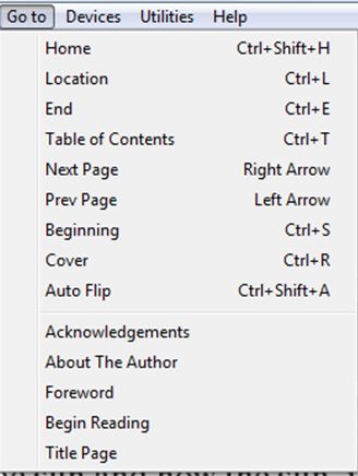

@eschwartz-- understand that the type="text" is the one where the ereader will take you to start reading. I thought that the type=other.Char2" will add a 'Go To point in the ereader, but it doesn't. If it did, I could add quick reference / bookmarks (?) easily to find the reference table or something
@theducks -- I think I added the dot correctly but it doesn't make the two Go To points I'm using for test show up

I'm beginning to think that it's not going to work

@eschwartz -- I think I must respectfully differ with you
Feel free to add custom semantics, but only you will know about them, because ereaders certainly won't.
If I edit the AWZ3 version by adding reference type="other.quickref", then it shows up in the Kindle reader under the GoTo menu

3. If I manually add this to the guide section in the AZW3
<reference type="other.quickref" href="text/part0001.html#Table_of_Data" title="Quick Ref Table"/>
4. Then it shows up in the Kindle GoTo list (screen shot)
I really prefer to stay in the epub format for editing and convert if required (even if I had to enter type="other. " things manually)

Nope, try it on your Kindle -- doesn't work on my Kindle Touch.
Dunno why Kindle Previewer shows it -- must be a glitch.

@escwartz -- Nuts. I hadn't even gotten that far yet. It was just much easier to use the Kindle Previewer on the PC to see
The Previewer was showing as a Voyage, so maybe a Voyage is able to show
