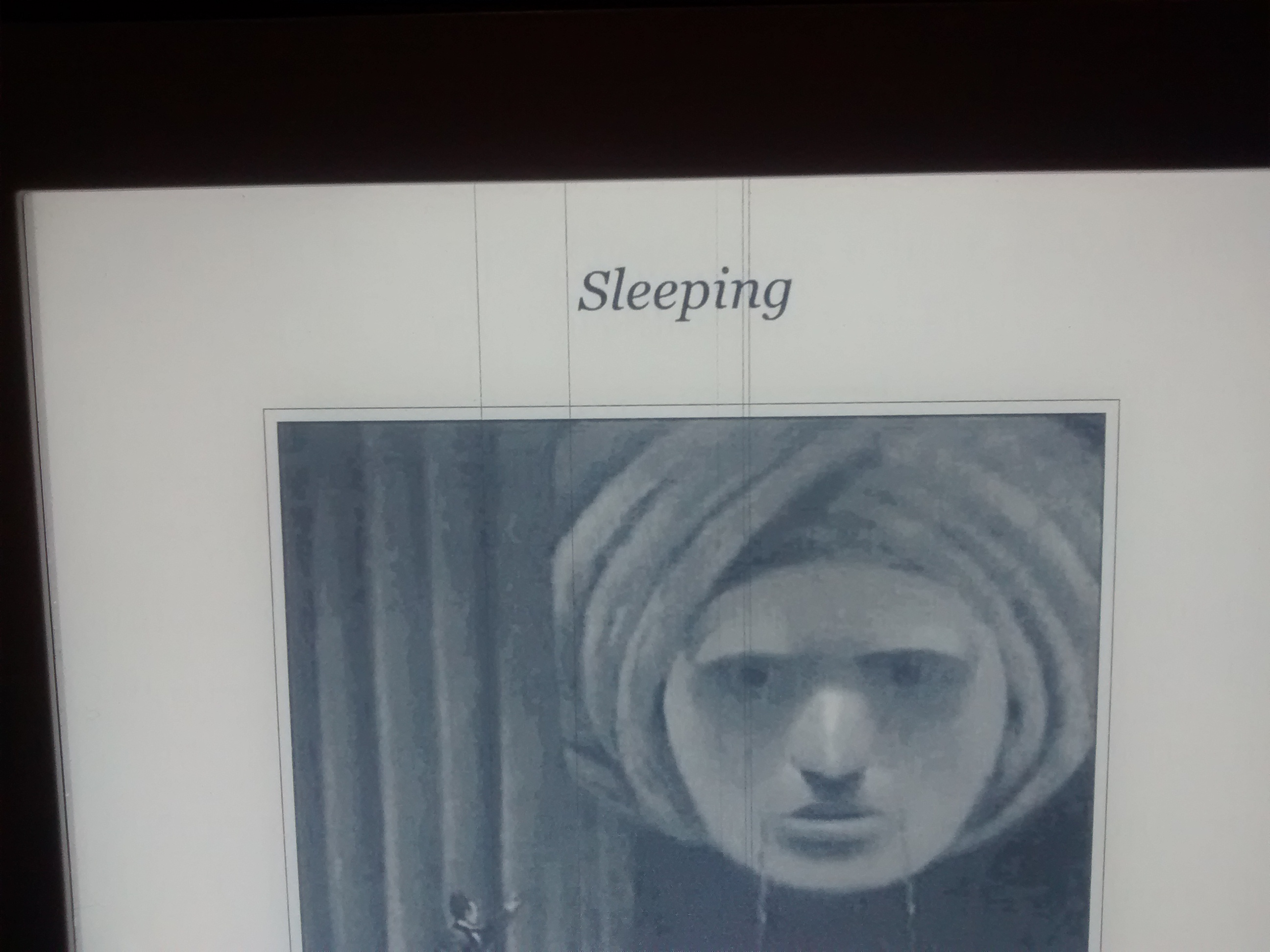

My Aura HD (just one year old) has just broken I don't know how.
I just closed my sleepcover this afternoon and when I opened it again the Sleeping + Book cover screen (although slightly corrupted with 4 thin black vertical lines) stays forever.
At first I thought it was one of the not-so-rare device freezings. But I cannot recover it in any way. I've tried:
  • The long power button slide.
  • The pin hole reset button press.
  • Even a manual factory reset (light button press + power button). I've get even the fast blinking light process Kobo says in its troubleshooting help.
But the device doesn't recover. At the beginning I thought it was that the screen has broken somehow, but it doesn't really seem that. I mean, with the "soft" reset (long power button slide or pin hole button), the device test led blinks as usually within a power-on cycle. And both the screen front light or the power on/off cycle seem to work (remember that my screen is fully blocked so I cannot actually know what's happening). But there's something else going on because:
  • Sleep doesn't work. I mean with the front light turned on, a short power button slide doesn't turn that light off.
  • I cannot connect the device to a PC. Even touching around the area where the "Connect" button should be, the PC doesn't recognize it...
(Although even if it were "just" a screen issue I can assure that the device hasn't suffered any kind of blow or crash...)
A huge disappointment. I've been struggling with all the Kobo software annoyances for a year, I was even decided to accept them, I was even probably going to upgrade to the Carta H2O...
Sorry guys I'm leaving Kobo forever. It's really sad but I fear that my only feasible choice is Kindle Paperwhite despite its smaller screen... (and its capacitive layer on top of it). On the bright side I'm going to save some money versus a H2O, and I really hope it would be free from all the stupid Kobo software issues (beginning with the flattened TOC and ending in widows and orphans not working)

Sounds like you have a broken substrate, IF those lines are still there when you do things you do to try and fix it.
If that is the case (and I hope it isn't), then your Kobo is useless.

I'm concurring with Dr. Crib, it sounds like a broken screen. It doesn't have to be a blow or a crash to cause the thin glass substrates to crack. Enough pressure on the screen will do it. Twisting will do it. Oddly enough, you can do fatal damage to a screen and the frozen image doesn't emerge immediately. I had a K3 that I dropped a few years ago and the frozen image didn't show until several days later. Imperceptible damage to glass tends to travel. I'd love to tell you that Kindles are different...they aren't. They use the same eink screens as Kobo. Unless the eink screen is one of the new bendy types (very expensive), they're very prone to breakage.

It really doesn't seem a broken crashed (physically I mean) screen. I would upload a screenshot but I feel it's pointless.
They are four perfect vertical lines made by pixels in black so it looks as a corrupted something (or broken controller or whatever) rather than a physically damaged screen. OTOH broken eink displays don't usually stay completely frozen. You get partial damages, dark/light artifacts in the crashed areas, or whatever, but not a fully static image...
But even with a broken screen there are other symptoms like sleep not working or being unable to connect to a PC.
And as I said I do not even remember dropping my Aura HD once. (OTOH my old PRS-650 has suffered one thousand hits. It's even glued in the bottom and it perfectly works, but because of the battery bug PRS+ introduced)

It does sound like a broken screen. Can you post a few images so we can see.
if you reset the device and the screen does not clear its most likely is broken. how ever you can reflash the image if you go to the developers corner if its bricked.

As you seem quite interested here I upload a picture from the upper part of the screen where the lines appear.
Nevertheless as I've said, I don't really think it's "just" a broken screen as the device doesn't seem to do the sleep/wake up cycle or I cannot connect it to my PC. So there's no way I can flash a fresh software, image or whatever.
In either way, being a broken screen (I don't know how) or a broken whatever (I don't either know how), my AuraHD is useless... Even being my fault somehow, (or just bad luck), I need a replacement (although I will also contact Kobo service, just in case).
And I am somehow fed up with Kobo and its software oddities, (and maybe building quality?), but a quick contact with a Kindle doesn't seem much better...
