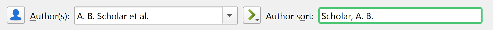

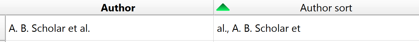

I have a bunch of papers which I want to add to my Calibre library. Many of these papers have multiple authors and are labeled "scholar et al.". When I try to edit metadata manually, Calibre seems to understand that "et al." is not part of the name, and suggests to author sort as "Scholar". However, Calibre will still sort the paper as "al. scholar et" unless I edit the author sort of every file manually.
I have a feeling I'm missing something really simple, but the best solution I can come up with is to tweak the author sort algorithm to include "al." as a copyword ("et al." does not work), which is ok most of the time, but not always. How can I make calibre automatically ignore "et al." when sorting authors?
ID:	180393   Click image for larger version

Use the bulk metadata edit dialog to automatically set the author sort, for all books, if as you say calibre is suggesting the correct author sort, then that should work fine.
If I go to edit metadata in bulk and just just tick the box for "automatically set author sort", nothing happens. It will be showing the same red box in author sort if I try to edit metadata individually afterwards. That is if I got your advice right.
Even if I manually press the sort button in the individual edit, or manual write my preferred sort value in the bulk edit, the actual sorting will not change. The only thing that has changed is the author sort value in the edit metadata dialog, not the author sort value in the manager author dialog. The only way I can make it correct after loading the file is to manually change the sort value in the author manager.
I get a feeling that I just need to change a setting somewhere, but I can't figure where that would be.

I dont see how that could happen, but you could then just use the search and replace tab of th ebulk metadata edit dialog instead to remove et al
Oh, I didn't try that before. Unfortunately it doesn't work either. Again, it will be changing the author sort I see in the individual edit dialog, but not the author sort in the manage author dialog. If I have previously done the automatic sort with the individual metadata edit, the bulk search-and-replace will not find "et al." because it is already removed from author sort (but not in the author manager). Calibre seems to be storing two different author sort values for each file and only tweaking the one which is not used to actually sort the data. BTW: I tried to update Calibre before starting this thread, so I'm running the 4.20 version. It didn't help the problem.
