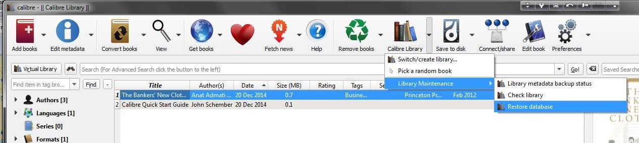

  1. Do you have a backup of your library folder, if you do then restore it, in its entirety.
  2. Did you try restoring the database (thats metadata.db in file speak) - see attachment - it may take a while.

Question 2 – yes I did. I restored the database file or I should say I allow the program to reconstruct the database file from the individual books that were in the library. This made no difference in the program's behavior. It still freezes up after the database reconstruction from the books contained within the library. By the way all of the books are contained within multiple subdirectories . The library itself is the directory immediately above that – that contains all of the subdirectories.
