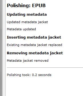

Terisa de morgan - yes if you tick remove and add you will have no jacket, because the remove is done after the add - I think Polish has always been like that.
FWIW - the Modify PI does the Removals first and then the Add - so you will always end up with a jacket
