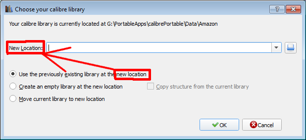

Everything you say is absolutely true! So, NOW, the "Calibre Libraries" DOES have a metadata.db file in it! But obviously no books.
So, how to proceed from here. You say to use Create/Switch to add the others - which of the selections do I use? There's a choice of "Use the previously existing library at the new location"; "Create an empty library at the new location" [I don't think I want this one!]; or "Move the current library to new location" [This one doesn't sound right either!]. I guess if the first choice read "Add an already existing library" I would have tried it but the wording kinda scares me!

Since you have Existing Libraries (Libraries have their own Metadata.db)
Use existing at New (lost/forgotten?) Location
As you can see:

"new location" is a reference to the location you choose.
  1. Assume the "new location" is a pre-existing library, and use it. Add it to the list of libraries.
  2. Assume the "new location" is an empty folder, create an empty library there.
  3. Assume the "new location" is an empty folder, move the current library there.
To be honest, I have never loved the wording myself.
