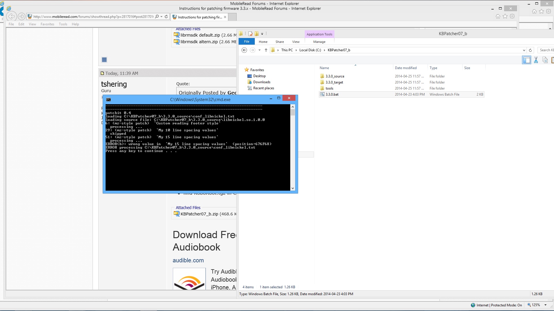

Hi Tshering:
Your method is way easier than the one above (post 12). However, I get an error, see attached file. When I remove the 15 line spacing code and use the 10 line spacing code, I get a similar error.
SHunter

Originally Posted by SHunter101 View Post
Hi Tshering:
SHunter
I tried again with both line spacing patches. And both run without error. Is it possible that something happened to your configuration file, or that you use a libnickel.so.1.0.0 that has already been modified?
Edit: Since the error is at 676F68, I wonder why GeoffR writes twice at this point:
replace_bytes = 676F68, 86 EE 1D A3 D3 E9 00 23, 00 00 00 00 00 00 F0 3F
replace_float = 676F68, 1.0,  0.7
But this does not explain, why it is working for me, and not for you. Or did you by chance change one of these two lines? Since this would result in an error.
