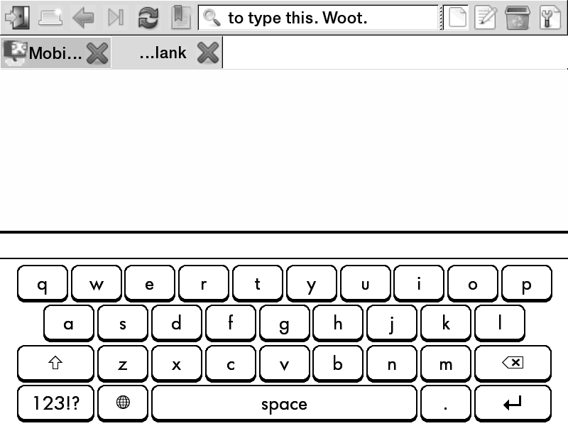

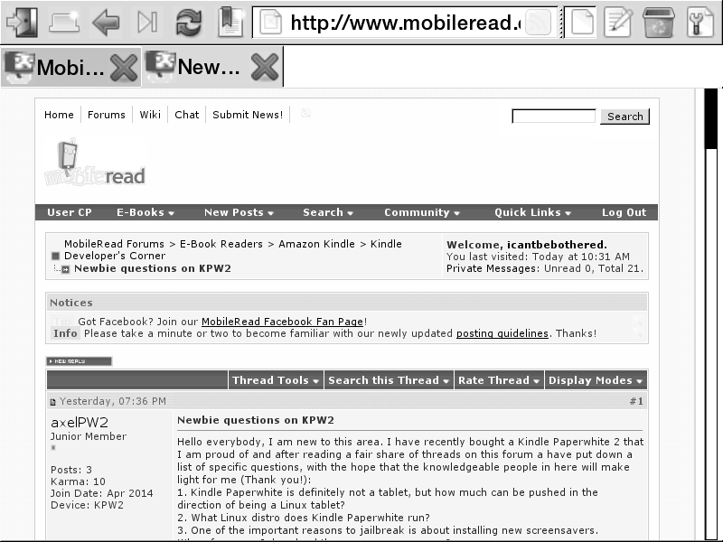

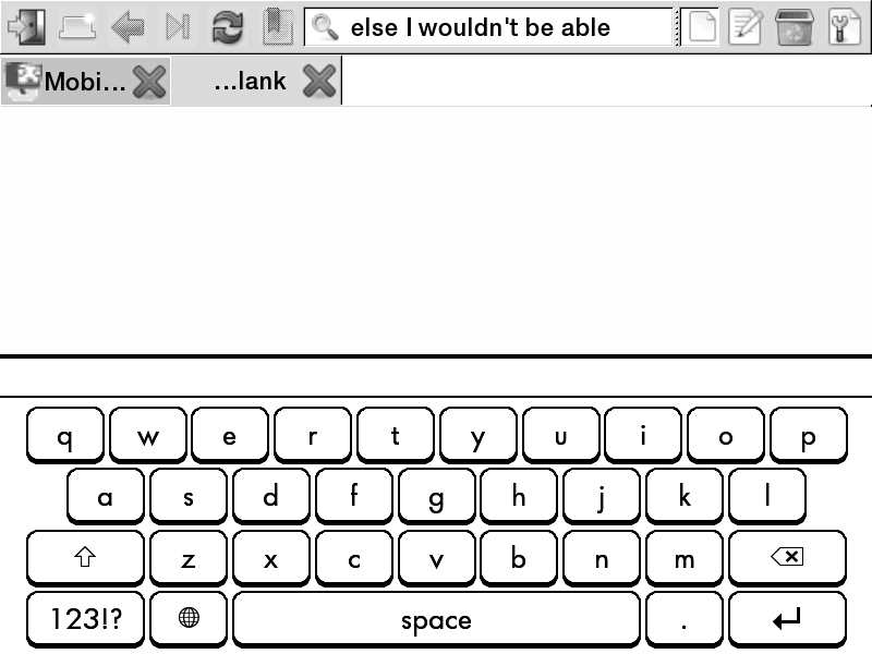

Originally Posted by knc1
The last that I recall (dis-claimer: I have a faulty memory), the author of that effort was having some problems with pop-up windows that over-layed parts of the keyboard.
Someone that was (or is) using it could probably give a better description of its current status.
Midori is currently at release candidate 4, and working nicely on PW1 and touch. AFAIK nobody has tried running it on a PW2. But it shouldn't explode (neither should skipstone). Amongst other things, I like its tendency not to crash. And the pop-up windows are a thing of the past.

Its looking good now. At one time, it used to choke on Mobileread's Javascript.
Thanks for the update on its status.
