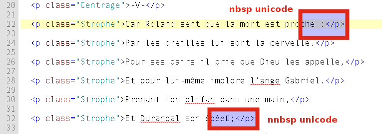

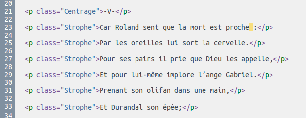

@DiapDealer
Thanks for your reply. As I explained above, I can't use Sigil 0.7.3 after checking or "beautifying" an EPUB with the calibre editor because it complains about the missing DOCTYPE et recreates nbsp as named entities.
I tried Sigil 0.7.4 (with Wine) after checking or "beautifying" an EPUB with the calibre editor and, at least, these problems are gone.
A first screenshot with calibre's editor shows how nbsp and nnbsp are displayed. For the second entity, I had to read its name in the lower right part (screenshot 2).
To finish a screenshot of a short text with Sigil 0.7.4 showing how nbsp and nnbsp are displayed (the last one with a white square).
To conclude, I think a binary of Sigil 0.7.4 seems to be usable after calibre's editor without creating some new problems and for this reason would be much appreciated.

0.7.4. do not creates errors. However, it fails to recognize nbsp in their new unicode dress and deals with them as a common space. He also has no clue about the "new" nnbsp which is identified as an unknown character.
This means that, even with 0.7.4, if you wish to perform some task regarding the entities you are out of luck. But Sigil does not seem to damage this file: if you are perverse enough to open it again in the calibre editor, your entities are unmodified in their Unicode dress.
