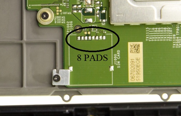

It seems that there is an unused pinout for sim cards on the PW3. Looking further into the sim card standard it seems that they have begun to implement a purpose for the 7th (Serial I/O) and 8th (USB-ICC) pins. Rather than the standard 6 pins I have seen.
According to ISO/IEC 7816-12:2005, USB-ICC is another area in sim cards that can be utilized for additional data.
Would this be a viable place to implement extra storage capacity? Seems far-fetched, but interesting.

A better picture of the board with a revision number will be possible later when I take apart my own to solder a serial interface. I have borrowed a picture from a disassembly for the time being.

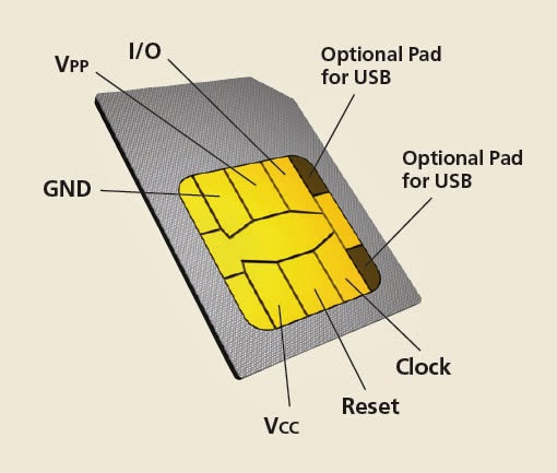

It seems that companies are looking into implementing this extra sim storage for carrier data management as well as updates and or preferences. SanDisk has a document detailing some of their solutions.
As for the pinout, I am unaware of the pin assignment and if the extra two pins are the new standard being used or an extra ground. I would like to get a sim of that generation and a shield to test if its storage can be accessed as is, then pursue further methods of bypassing it to a more traditional storage chip.

As for the 8 pins on the sim pinout I have found the identical layout on my revision.

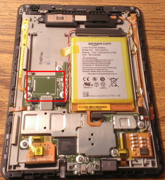

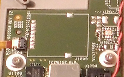

Someone with their Voyage open also please take a look for that part outline (don't count on the silk screen to label it).
Is this what you wanted?

Note Wifi-only KV.

But mini pci-e has 52 pins. The Kindle (looking at this picture and my open PW2) only has 50 pins. What is the mapping between mini pci-e and the Kindle connector?

The PW2 (and the PW3) only have 50 pins. See the image above (8pads.jpg) where you see one row of the (unpopulated) connector. That's 25 pads on one side (25 on the other, not in the image) and they are even labelled - the top ones (left in the image) 1 and 2, the bottom ones (right in the image) 49 and 50. Plus an additional pad on each corner (I assume these are for soldering on the connection edges).

Also want to mention that this area in the PW2 looks exactly the same as in the PW3 picture (post #3). So this is not a new 2015 design.
