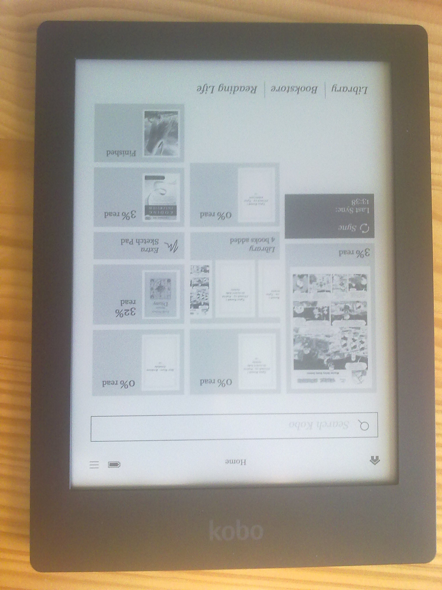

It is new Aura HD with firmware 2.8.1 and I am new Kobo user.
My Aura has flipped screen. Please see attached file.
What I did:
- add 4 comics (*.cbr)
- only one file I was able to open. On rest it blinks and shows library.
- because I'm new i was trying view settings and i found that i can flip page (on that working comic).
- I have done 4 flips (90 degrease per each) and I decided to delete not working files (in this step library view was good)
- After first delete reader restarted with flipped screen and reboots over and over again (even in usb mode).
What can I do?
How to restore to factory defaults without screen (i cannot go to settings)?
Sorry for my bad english.

Hold down the light switch and hold the power/slide switch, until the light flashing indicates it is starting the restore routine. (As I remember it.)

What Ken said EXCEPT that before you do that you need to hold the power switch in the on position for 10-15 seconds to make sure the device is truly turned off. In this case probably just powering down (so it shows POWERED OFF on the screen) would be sufficient, but doesn't hurt to make sure.

Thanks guys!
I have my aura back
