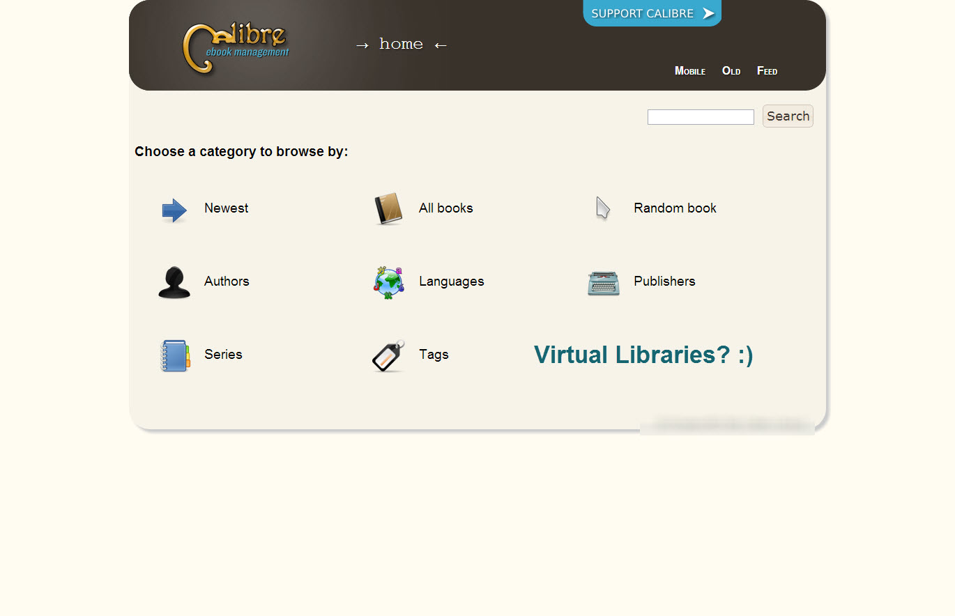

Hello,
Is there a way to get virtual libraries to show up in the web interface? That would be handy for browsing and I was just curious if I could enable that somehow.
Thanks!

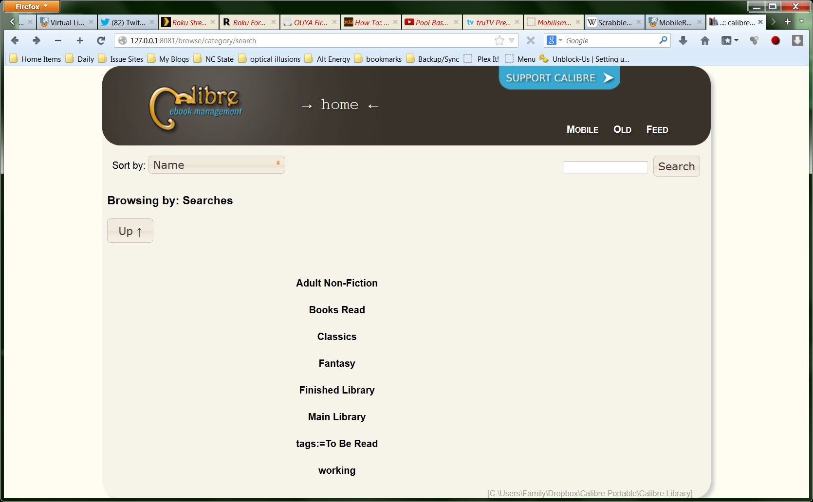

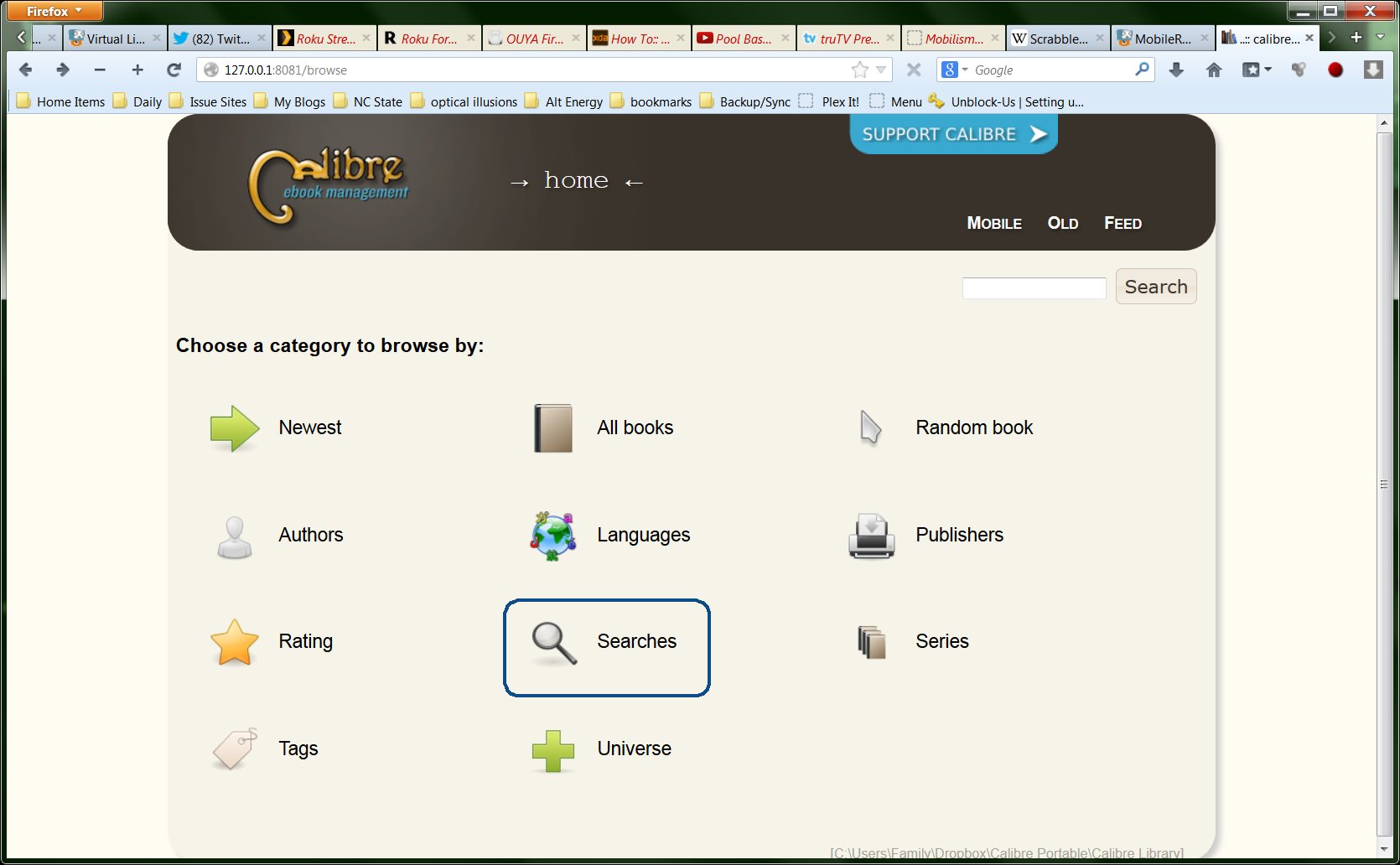

No you can't get virtual "libraries" on the web interface. You can specify for the Content Server to be limited to showing the contents of one VL on start up. Go to Preferences - Sharing over the net and enter a Virtual library to apply on start-up of the Content Server.
Update: I'm sort of wrong. Press the Search button in the menu and it will give you the option of your saved searches including each VL.

Originally Posted by soundsfromsound View Post
I'm afraid I don't follow. Search button, in the web interface? I only have a search box. And a sort option.
How do I get to that saved searched/VL option you speak of?
Sounds like what I'm after.
I'm guessing you have no saved searches or VLs setup. See attached.

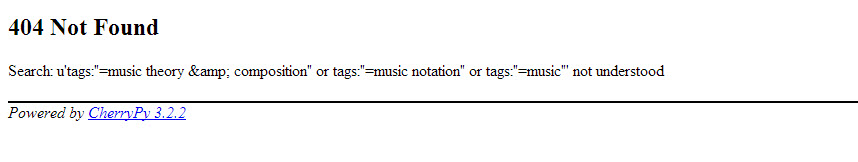

I opened one virtual library, copied the search terms, and tried to copy those and save a search but I get an error when loading saved search from web interface:
Search: u'tags:"=music theory & composition" or tags:"=music notation" or tags:"=music"' not understood
So, even though I have virtual libraries I can't seem to get them to register as 'searches' on the web interface. Not sure what I'm missing.

Hmm, still failing. Same error. I am copying the search terms exactly as they are from the virtual library, and making sure no single quotes exist.
The single quotes are being added in the 404 page error message, they were never part of my saved search, if that helps.
404 Not Found
What should I do?

It's probably caused by the amerpsand in the search query, open a bug report for it and attach the metadata.db file from your calibre library folder.
