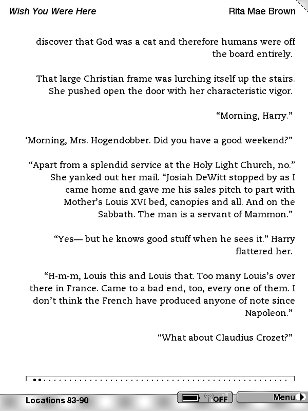

I used one of [dark reverser's] tools mentioned herein and got my books into an html format. Then I used html2mobi on a PC (the exe version) to create a file for my Kindle. Alignment clauses that are normally cancelled by an end paragraph mark </p> (dunno if that will display here, or not) were not cancelled. Thus, the chapter titles specified one thing, and the rest of the book carried it onward.
I wound up reading the whole book in right-justified mode. Ragged left, justified right. Boy, was that weird..... But at least I got to read it.

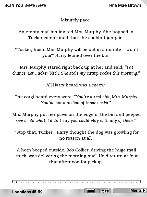

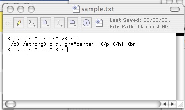

Here's a sample of the oddity of reading a book center justified (not too bad) or right justified. Tompe -- mobiperl is yours, isn't it? I was able to fix this by inserting <p align="left"> after each chapter heading, but I'd hate to do that to all my books. Maybe I'll just enjoy reading strangely!
Oh, I'll attached a small sample of the html for a chapter heading, and the align left line I added to fix it.
Yes, mobiperl and html2mobi are my programs. I cannot reconstruct the HTML code to get your problem. Could you give me the complete code for the chapter heading and two paragraphs following it? The example you included had </strong> and </h1> but no start tags so I suspect it is not compleat.
