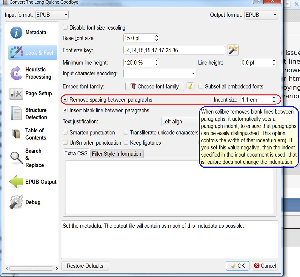

Please help! I have spent hours trawling through threads trying to solve a simple issue. I make my ePub files using Word, via Atlantis. For the first paragraph of each chapter I set the paragraphing of the first line to 0 (following normal conventions), while the rest of the book is 0.5. When I convert the ePub to Mobi using Calibre, however, Calibre forces all paragraphs to indent. But I need those first lines at 0. How can I stop this? I don't wish to enter html code etc. I simply want to tell Calibe to leave all the paragraph first line indents the way they are. Apart from this annoying issue I am very happy with the resulting mobi file and do not wish to create a mobi file in any other way due to various reasons.

Calibre only indents paragraphs if you tell it to during conversion. You have two options:
  1. Uncheck the box next to Remove spacing between paragraphs (see attached circled in red). Checking this feature also enables the Indent size box.
  2. If you want to remove the spacing between paragraphs then, as described in the tooltip, (see attached circled in blue) insert a negative value in the Indent size field, -.1 should do.
I hope this helps.
