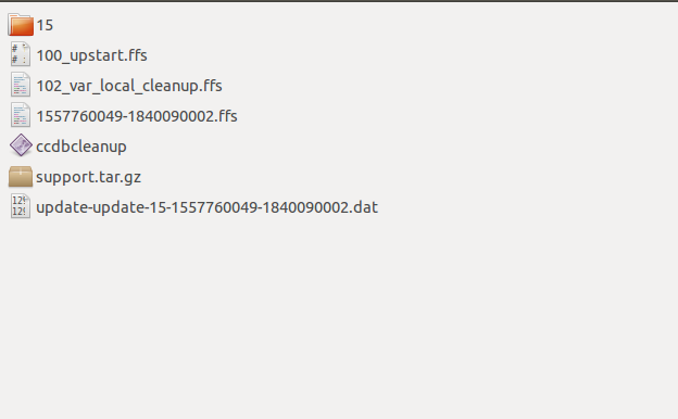

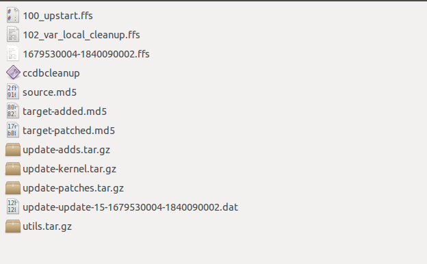

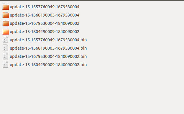

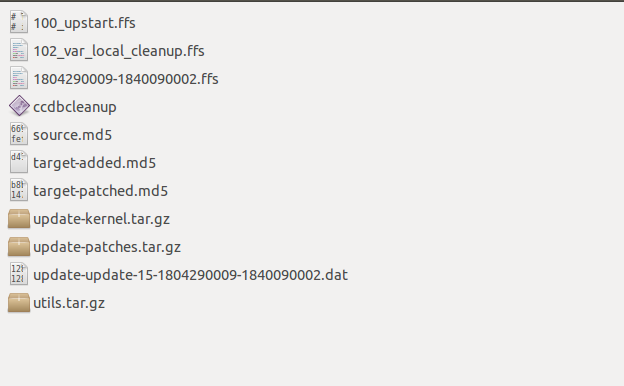

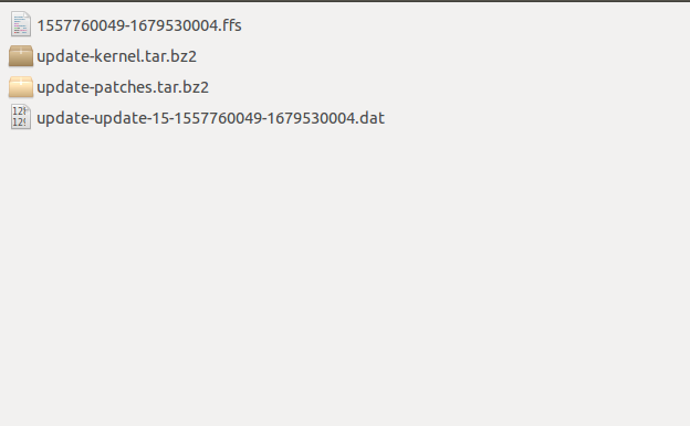

By the way, I also unpacked the 5.3.2.1 update file using kindletool as an effort to get the kernel, see screenshots for details. In the folder 15, there are 4 new update files following the pattern of update-15-*.bin. When extracted, each contains a file called update-kernel.tar.bz2 that in turn contains an uImage patch. I do have the 5.1.2 kernel, so any advice on how to apply these patches is appreciated.
