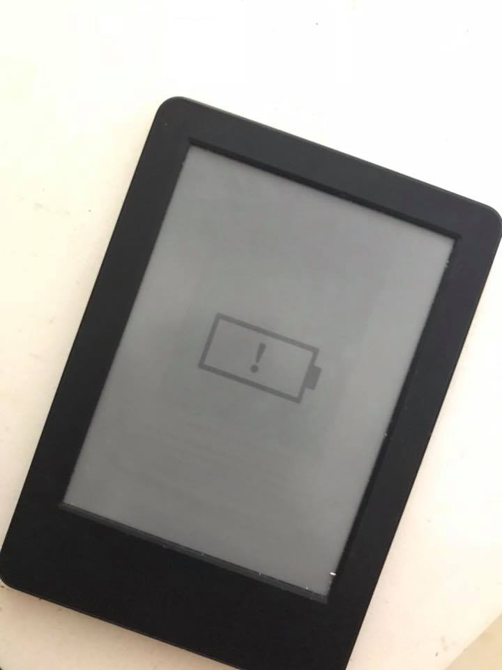

Hello there! I NEED HELP! This is my kindle... there was a while since I lost it and now that I found it, it looks like the battery is dead 💀 but when I plug it nothing happen other than the little yellow light turning on... so I tried holding the button for 20 seconds and nothing, then I tried holding it for 70 seconds, again nothing, then I tried charging it for 1 hour and then the button for 20 seconds and charging it again and nothing... 😫 I don’t know what to do... I know it works because when I connect it to my laptop, I can see all my books there...
What do you suggest? Has this happened to any of you?

Plug it in, go out for a lunch and/or dinner date, have a cappuccino, catch a good film, then get a drink or two (you know your limit), then come back home and see if it took the charge.
Translation: Give it more than an hour.

Do what Dr Drib said, then go to bed and check it in the morning.
I recommend 24 hours.

Oh and it has to be unplugged for it to reboot by holding the power button.

Something to be aware of is that if a device with a lithium ion battery, such as a Kindle, stays dead too long, it's designed to stay dead. Dead really means the battery is totally dead, not that the device won't start by itself. Devices will refuse to come on but can be recharged long before the battery is really totally dead.
The problem is that once the battery is truly flat connecting a charger to it can cause a fire and that's why they're designed not to let that happen.
Anyway, the advice you got above is good advice and I'd try it at least overnight before giving up. But then if it still doesn't come on you might consider replacing the battery.
My Paperwhite 2 battery was holding a charge for less than a day so I ordered a replacement battery from Ebay for $10, I think. It arrived this morning. It came with all the tools I needed. I went to Youtube and looked up a video on how to replace the battery for my particular Paperwhite. I watched it a couple of times. I started taking the Paperwhite apart.
First, it wasn't much like in the video at all although watching that video first was extremely helpful. There were enough things in common that I was able to figure out the differences. Second, that's easily the sloppiest, clumsiest and scariest thing I've ever done. And when I was a kid I used to ride in airplanes with a guy who loved flying under bridges. This was way scarier.
About half way through getting the case apart I was convinced that I simply wasn't going to be able to do it but at that point I was fairly sure I couldn't get it back together anyway so I figured I might as well keep going. I did. Everything you can imagine went wrong and yet right now my Paperwhite is charging it's new battery and working perfectly. i have no idea how I managed that. I've been an atheist most of my life. Maybe it's time for a prayer of thanks.
So, for $10 and 20 minutes of terror I now have what seems so far to be a perfectly good Paperwhite with a brand new battery.
