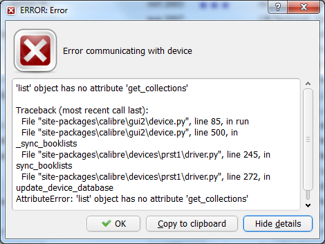

There is certainly an error here as I now get the following error. Previously it worked, but now I get the same problems as indicated above. I will downgrade to 0.9.15.
