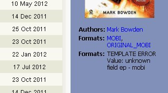

Hi' I have a major problem here. Firstly every file I try and convert shows "Template Error"sign just above the "Converting Widget" in the Calibre GUI (see attach 1)

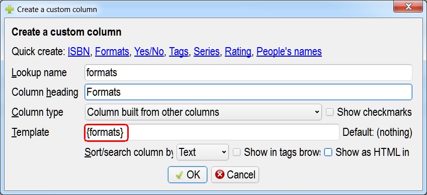

It means you have a custom column with an invalid template.

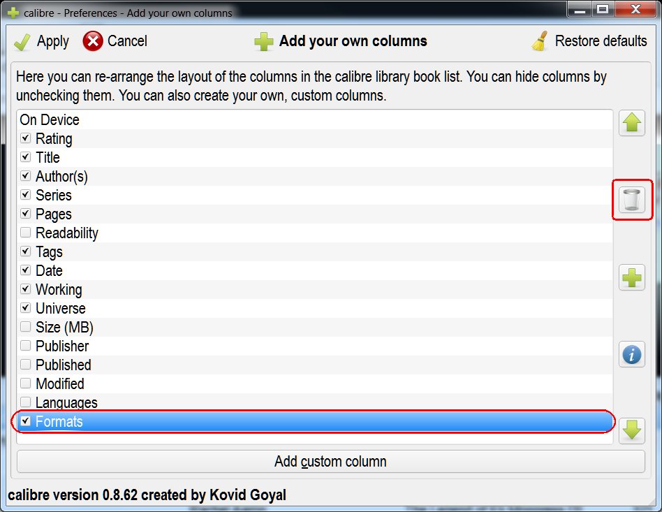

Judging from your attached image, you created a custom column with the title Formats. That would be the column where your invalid template is located. The name directly next to the Template Error is a clue (see attached I circled it in red so you won't miss it.) The template for the custom column called Formats, by default creation, looks like the attached (again circled in red for your convenience.) I'm guessing your template is messed up. Either fix the template or go to Preferences - Add your own columns and delete the custom column (see attached).

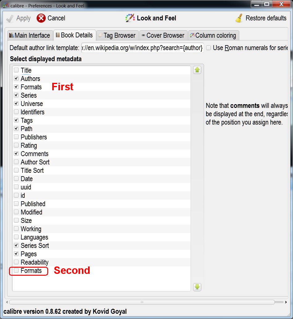

Alternatively if you don't want to deal with the complication of fixing the template or deleting the custom column you can go to Preferences - Look and Feel - Book Details tab and uncheck the second Formats you find in the list (see attached, labeled and circled in red to remove all doubt.)

Name:	CalibreTemplate Error.jpg
ID:	90002   Click image for larger version
ID:	90010   Click image for larger version
ID:	90011   Click image for larger version
