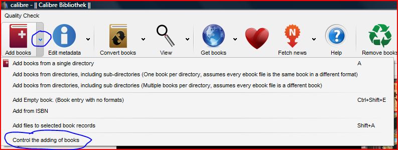

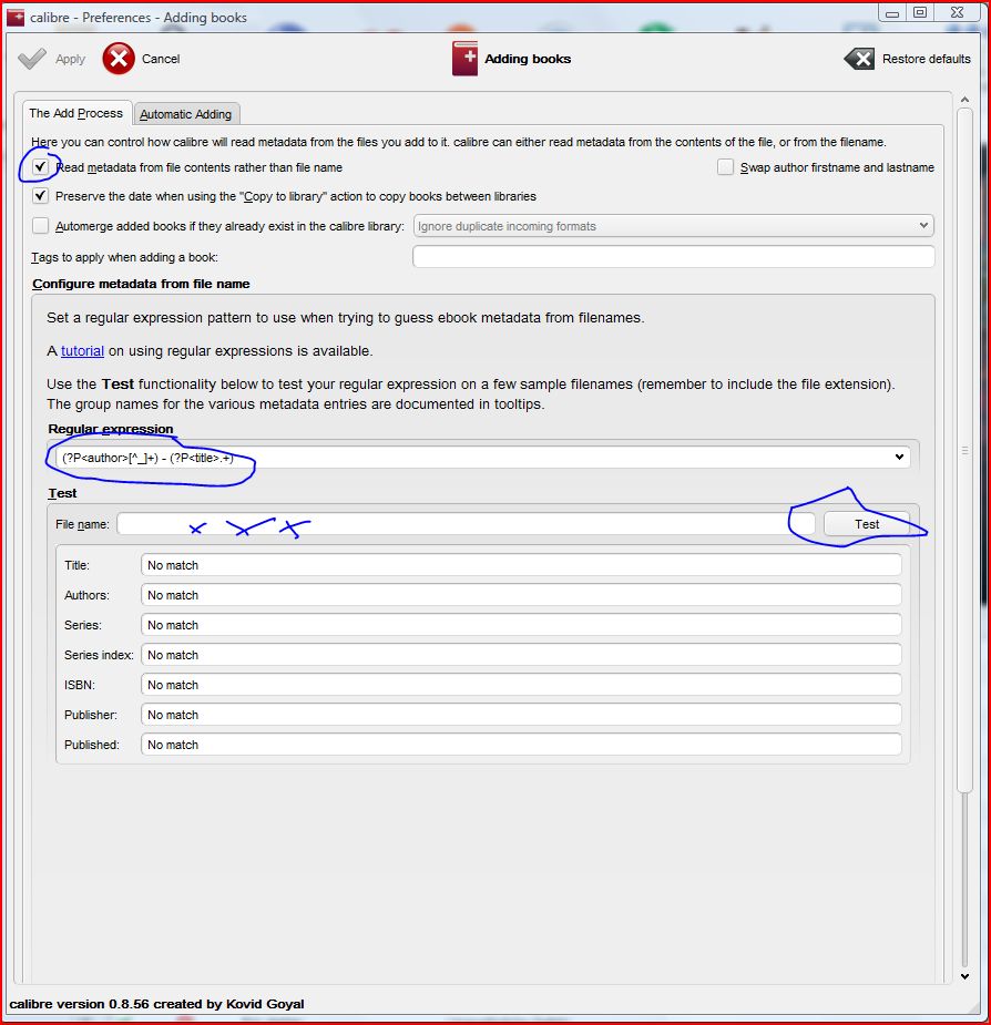

Build a new library. Open setup in the add book dialog (pic 1) setup the correct entries (no check for "read metadata for content rather then file name" (pic2) and take a matching regular expression. You can test it when you put under File name a live example i.e. "Dirty, And Quick - This in an example.pdf" and then press test. Then you will see what happen with your metadata.

no, you can do both. The trick is to use a other field for your file name.
Lets look at an example. Your file name is "10201155.pdf"
In the PDF you have define a title and an author. I use for this example the series field. You should create a custom column for your library to store the document number.
Go to the import dialog and put in (?P<series>.+) as regular expression, check that "read metadata for content rather then file name" is selected and apply the change. When you test it in the same window with file name "10201155.pdf" you will see the file name "10201155" in the field series. Now add one book for test (check before running that the metadata are in the file on the correct position).

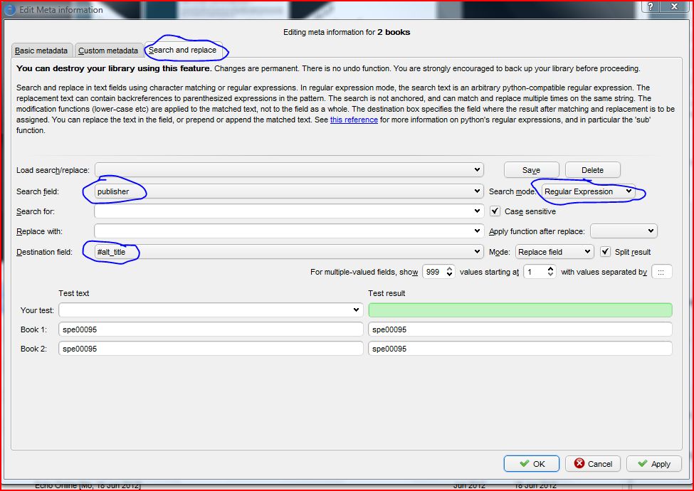

Edit: Here an example how to make a quick replacement from one to an other field
I use your regex (?P<publisher>.{8}) to move the extracted information in the Metadata Publisher
File name: spe00095428 calibre User Manual — calibre User Manual.pdf
Publisher will become "spe00095428"
In my pic below I import the file two times. Then mark the imported books and click on "edit metadata" and select tab search and replace and select in 'Search field' publisher and in 'Destination field' your custom field (here my name is '#alt_title'. After performing the change you will find the data in the right place. You can do then a second edit to clean up the field publisher.
Be careful and test it on an example. When you do it with a bigger count of books, be sure you have select the books you want to change. You can't reverse these action.
