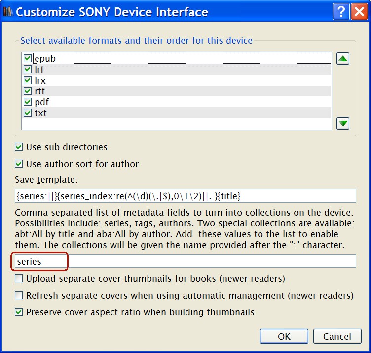

If you set the series and series index, open the preferences->plugins->device interface->sony and set the collections section to series.
Then in your Sony reader, you can view collections, the series will be listed and they'll be in order.

Series order support between Sony devices and calibre is perfect. As Perkin says you just have to have calibre create collections based on Series and the books in that "Series" collection will be in series order.

Since you already have a solution that works for you feel free to ignore the rest. I'm not trying to convert you. The great thing about calibre is the way we all choose to use it to fit our individual requirements.
However since you find the majority of your collections to be useless try narrowing the field. Currently I'm guessing your collections are created by calibre based on any tags and series info for a given book. You can minimize collections by not creating collections based on tags.

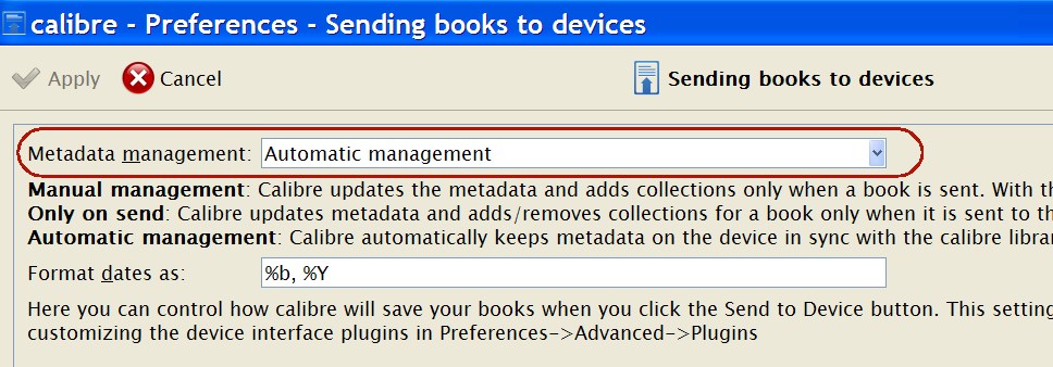

Go to Preferences - Plugins - Device interface plugins - Sony and customize. You will end up with some thing like my attachment. Ensure only Series is in the lower window. This will ensure the only collections created on your device will be based on Series information.
While you're poking around go to Preferences - Sending books to device and set metadata management to automatic (see attached). this will ensure any metadata you change will be automatically updated when you connect your reader for any books on your device.
ID:	66759   Click image for larger version
