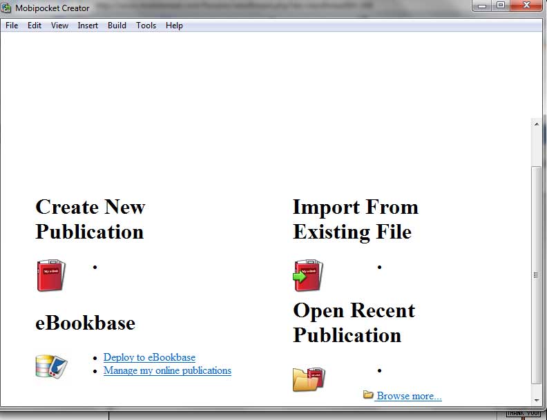

I run windows 7 x64 I am trying to use mobipocket creator without success. I can't give you much info other than that because the program does nothing at all. I have never seen the program function so I do not know if it is supposed to look like it does in the screen shot or not. the program opens as you can see, but that's all it does

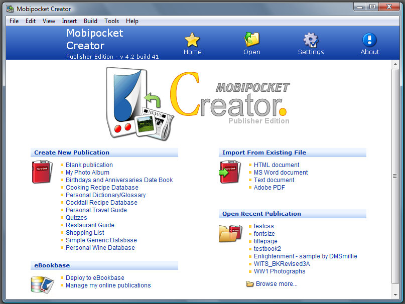

Definitely not what it should look like - attached screen shot shows the opening screen the way it should look (I'm using Windows Vista). Have you tried uninstalling it and re-installing? It's possibly a glitched installation.

Yes several times, I have tried running it as administrator and in compatibility mode as well. always looks like same, gives no error message of any kind. I just get that screen which does nothing at all.

Hmmm... well, it's just a guess, but Mobipocket Creator is a couple of years old at least, and no longer being updated (since Mobipocket was taken over by Amazon, and MPC supplanted by Kindlegen, to all intents and purposes) - I wonder if perhaps there's something in it that isn't compatible with Windows 7? It's the only other thing I can think of, I'm afraid. Maybe someone else will come up with something more constructive...

I created another user account and it works from that account. I just have to change users to use the app now, wish I knew why it wont work under my account though. better then nothing I guess...
