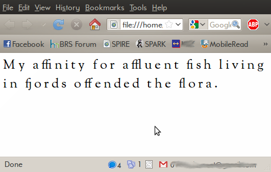

But apparently I was wrong about how smart Firefox is about this, although the results were strange. Testing this document:
<!DOCTYPE HTML PUBLIC "-//W3C//DTD HTML 4.01 Transitional//EN" "http://www.w3.org/TR/html4/loose.dtd">
<html>
<head>
<meta http-equiv="Content-Type" content="text/html; charset=UTF-8">
<style type="text/css">
body
    font-family: 'Sorts Mill Goudy';
    font-size: 200%;
    letter-spacing: 0.2em;
</style>
 <title>LigTest</title>
</head>
<body>
My affinity for affluent fish living in fjords offended the flora.
</body>
</html>
I got different results depending on the font-size. (And not just the font-size selected by the CSS, but it even changed when I used Ctrl-minus and Ctrl-= to zoom in and out.)
Have a look see.
versus
(This is from the same file, just zooming in and out.)
It just occurred to me trying with a <span> around every letter (or ligature), and styling this span with left and right margins... that should work pretty much everywhere, I don't think the <span>s add breakpoints or disturb text searching. This, of course, is only worth doing if there are just a few instances of spaced-out text.
I tested the suggestion of using separate span tags with margin-left and margin-right, and the results were better than I expected. Every viewer I tried was smart enough not to break at the wrong point, and the text was still searchable. Unfortunately, I have hundreds of emphasized passages in the document. It shouldn't be too hard to come up with a RegEx to insert them so I don't have to do them by hand, but it's still going to end up with messy code. I'll have to compare what adds more to my filesize too: inserting all these, or embedding another font per charleski's suggestion.
ID:	49358   Click image for larger version
