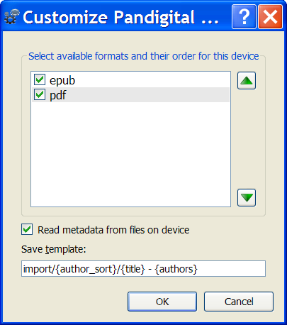

Originally Posted by Jay955528 View Post
I have a Pandigital and I am trying to sync with Aldiko. Calibre will not put the ebooks in the eBooks\import folder.
If you want to put them in the eBooks/import where the import folder is a sub-directory of eBooks then just add that folder in your plugin. (See attached)
Is there any way for me to fake out calibre and make it think that the pandigital is an android device? I noticed that the file structure is what i need. I tired disabling the pandigital plugin but then nothing worked
The creator of this program told you a simple method to meet your needs. Did you try using the connect to folder option suggested? The connect to folder option also has the file structure you need and gives you the same benefits as any device plugin.

I don't know if Jay955528 ever resolved his issues with the Pandigital Novel and Aldiko, but I'm having similar issues now. I tried to use Connect To Folder, but it is greyed out and can't be selected when the PDN is plugged in. Calibre recognizes that PD Novel is connected.
I've also tried customizing the device plugin. It doesn't seem to matter what I put in for a template, the books always load into /sdcard/eBooks. I have to send to Main Memory to get this to work. Send to storage card A and Send to storage card B are also greyed out and can't be selected.
I can change the metadata used to make up the file name in the plugin setup and that works, but I can not get Calibre to put the files in the /sdcard/eBooks/import directory.
It would be nice to get this working so Calibre is aware of which books are in Aldiko and which ones are not. Now, once the books are moved into the import directory and imported, they disappear from Calibre's view of the PDN.
Any more suggestions? It seems that Calibre is not using the directory portions of the plugin setup. Is this a bug or working as designed?
In order to use the Connect to Folder option the Device Interface plugin for Pandigital Novel needs to be disabled. Then connect your device and the Connect to Folder option will be available.

Device: Pandigital Novel
Sorry - I didn't realize that I had to stop and restart Calibre to get the plugin disabled. Calibre now shows Connected Folder Device. I connected to folder eBooks/import and that is where everything was sent. Great!
Shouldn't the template in the Pandigital Novel plugin work the same way, though? It seems to be ignoring the directory specifications and always sending books to the eBooks directory. The file name part of the template seems to work as documented, but not the directory part.
Thanks again for the help.
