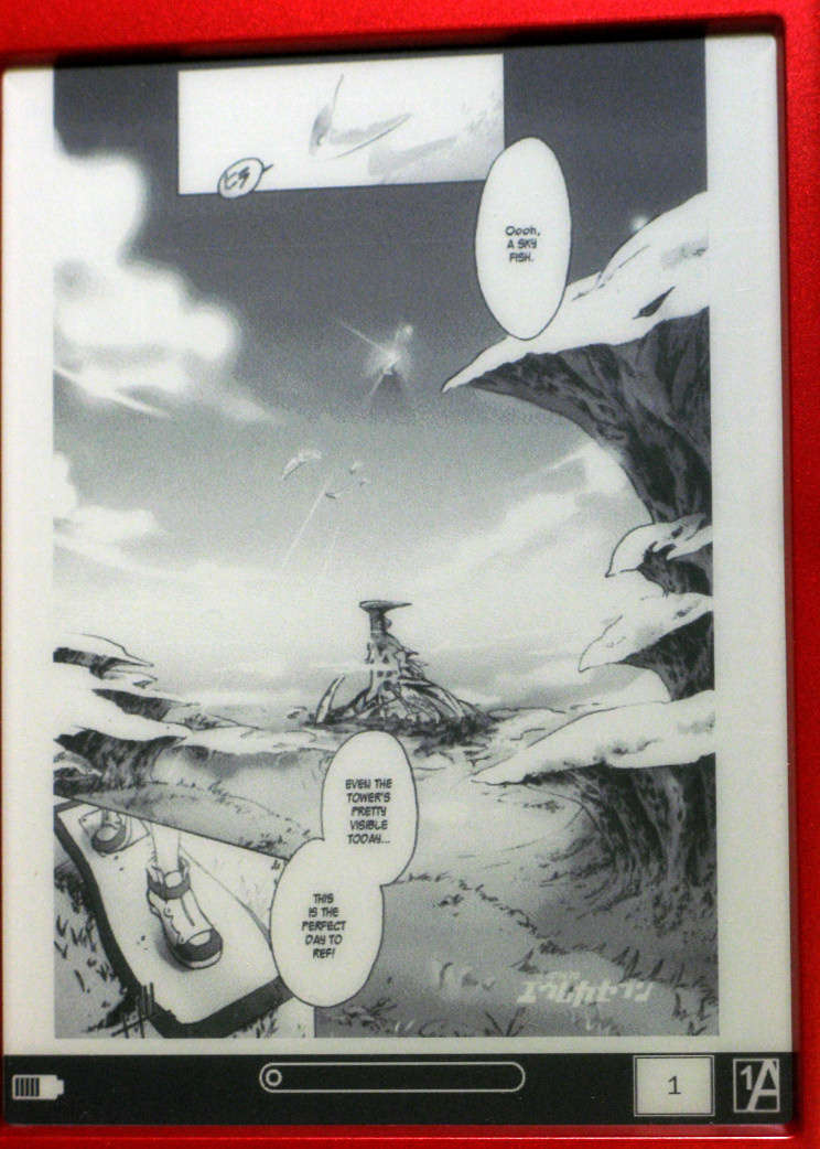

It's kinda hard to photograph an e-reader. At least, my camera isn't high enough resolution to get all the pixel details in one shot. I tried scanning the e-reader too, but the 3 mm recession of the screen wouldn't let it focus. Still, here's what I was able to get.
First things first, a color page of a manga with a good blend of sky and edge tones. (Eureka Seven)
