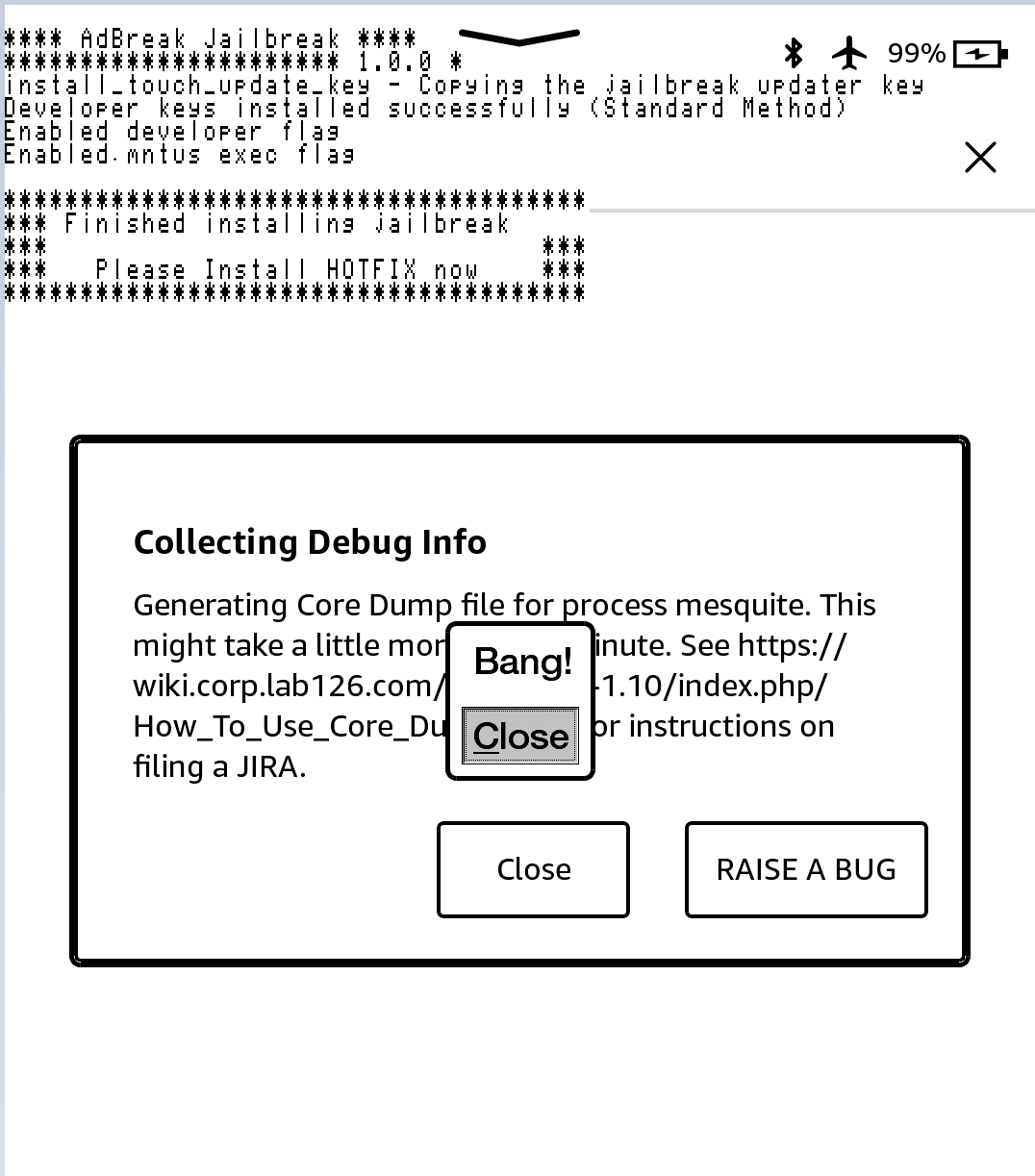

AdBreak - experimental JB for ad-supported devices (5.18.1-5.18.5)
This is based on an old Webkit bug (CVE-2012-3748), with a lot of code borrowed from Chris Evans (@scarybeasts).
Unfortunately, this is limited to ad-supported Kindles since Amazon hardened .active_content_sandbox after WinterBreak.
I've tested this on my own devices and haven't run into any issues, though this is experimental and hasn't undergone rigorous testing. Attempt at your own risk and let me know if you encounter any issues.

6. Plug in the Kindle, open the system folder and and copy ".assets" to your desktop.
7. Download and extract "adbreak.zip", copy the contents to the ".assets" folder on your desktop.
8. We need to replace the contents of all "details.html" files with the contents of "adbreak.html":
Windows: Double click on "replace.bat"
Linux/Mac CLI: find . -name 'details.html' -exec cp adbreak.html {} \;
9. Delete the original .assets folder on the Kindle and replace it with our modified copy.
10. Click on an ad and go through the popups, once you click OK on "Bang!", the jailbreak script should run.
11. Congrats, install the hotfix and enjoy your liberated device - https://kindlemodding.org/jailbreaki...g-up-a-hotfix/
