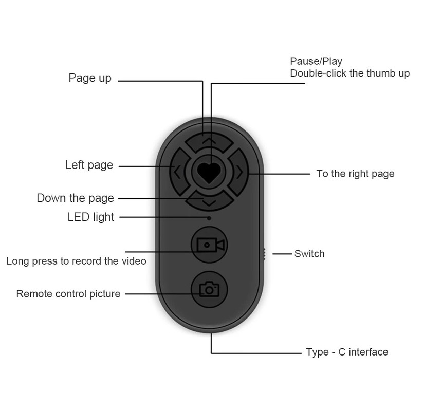

Originally Posted by WaveEquation View Post
Hello people, I'm wondering if there is a software similar to evtest for Mac to capture keycodes from a cheap bluetooth page turner device. (Got from Aliexpress. Image below.)
I go this device out of curiosity and with my config (based on educated guess) all the buttons just turn the page back. Without evtest I'm at a disadvantage here.
Things I've tested and confirmed working:
1. The bt remote works on my mac and Android phone flawlessly
2. My BT mouse works perfectly on my Kobo
Interestingly, I did see a post on this thread that led me to a blog post with the exact device as mine but it's a couple years old and the config no longer works.
The device appears as "Beauty-R1". I have a raspberrypi but I could never get the BT device connect with it. (Connection drops soon after it's paired.) So I want to give it one more shot before I buy a 8bitdo Micro.
My current config (which turns the page back for all the buttons)
Config from the blog post that worked for the author:
Mugshot:
Attachment 212020
I'm not well versed with the BT lore in Kobo parlance, but is there any hope for me?
I just bought a bluetooth remote with the name Beauty-R1 as well (looks slightly different but I'm assuming it's set up the same) and tried to set it up to no avail for the past few days but I finally figured out a configuration that works.
nextPage EV_KEY KEY_VOLUMEUP 1
prevPage EV_KEY KEY_VOLUMEDOWN 1
To turn the page, just long press the up and down buttons on the remote. Sharing it here in case anyone bought a similar device and was struggling to get the code working like I was.
