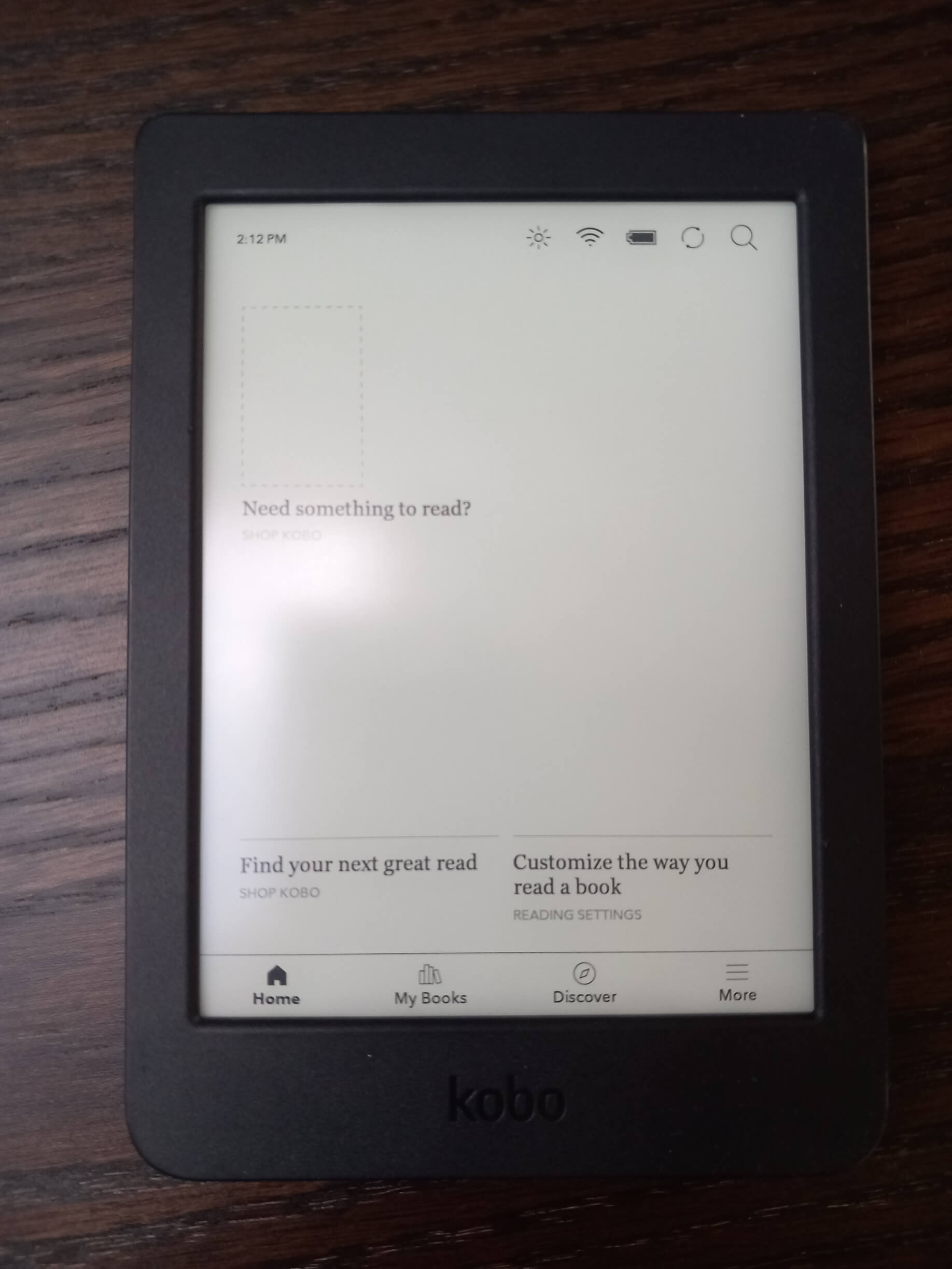

I bought a faulty Kobo Nia at a really good price. The visual condition of the device is very good, the screen is fully functional, but for some reason, the touchscreen is not working at all. I would like to request help in debugging and resolving the issue.

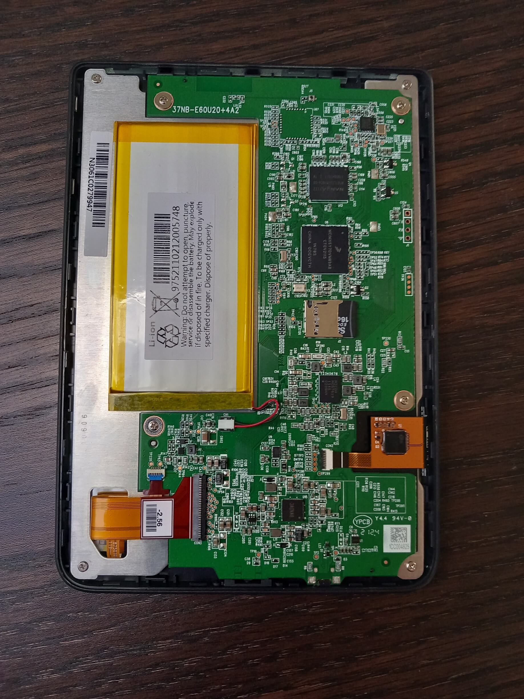

I have disassembled the device to access the SD card with the firmware. I examined the contacts to check if the device had been exposed to any liquid or if the ribbon contacts were corroded, but them are in good condition.
The device came to me reset to factory settings. While tinkering with the firmware, I managed to restore the device to its factory state, but it did not fix the touchscreen issue.

I also checked if it was a virtual device by disconnecting the touch panel, rebooting the e-reader, and observing that the system no longer recognized the Elan device. This indicates that the touch panel is at least being identified by the system.

I am currently stuck at this point and wondering what to do next. I am unsure how to electrically test the touchscreen panel. The issue is also quite specific, and I have been considering whether the touch controller chip may have been damaged, and if it's worth trying to order a new one and change it in (ELAN EKTF2232ALW chip). I wouldn't even want to attempt replacing the touch panel, and I'm not even sure if it's possible to purchase one separately.
Do you have any suggestions? Or has anyone encountered a similar problem here?
