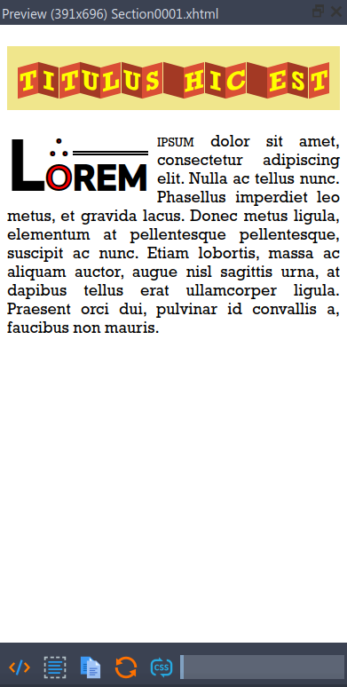

And watch the following .xhtml code:
<h1>TITULUS*HIC*EST</h1>
<p class="start">Lorem ipsum dolor sit amet, consectetur adipiscing elit. Nulla ac tellus nunc. Phasellus imperdiet leo metus, et gravida lacus. Donec metus ligula, elementum at pellentesque pellentesque, suscipit ac nunc. Etiam lobortis, massa ac aliquam auctor, augue nisl sagittis urna, at dapibus tellus erat ullamcorper ligula. Praesent orci dui, pulvinar id convallis a, faucibus non mauris.</p>
How can you give that specific code the following format (under epub2)?
Under epub2, you should have to add a lot of additional code to get something similar. In the epub3 I attach below, you can see how easy is to get those effects with javascript.
nthEverything Test.epub
