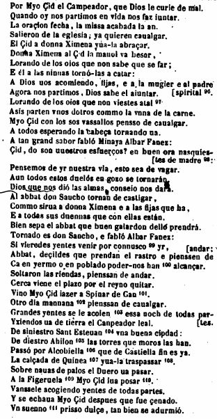

2) Breaking lines by aligning the 2nd part to the right, as in the attachment. I'm not sure this is common in English, but it's certainly done in Spanish.[*]
[*] Fitting the broken part of the line in the next ("[spirital") or even previous ("[andar") line would be extra nice, but I'm not asking for that yet.
