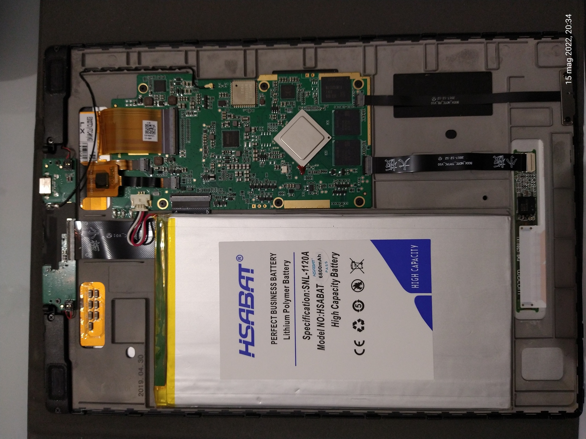

Thanks for the fast answer, I opened the Boox with the kit supplied with the battery, cut the three wires, unglue the old battery and put the new one by plug it to the connector and I glued with the strips supplied with the battery.
After that I tried to use the ebook to see if the battery drainage was normal and slower than before, finally I closed it cautiosly.
The battery seems last pretty long
