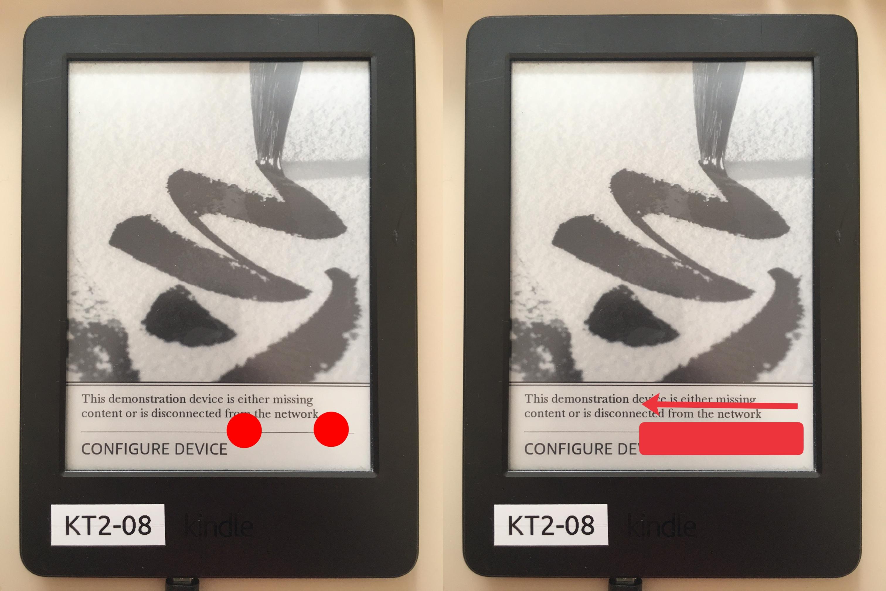

  8. Once the demo is setup, skip the misconfiguration lockout using the "secret gesture" (double finger tap on bottom right of screen then swipe left)

  • Video demonstration of secret gesture
