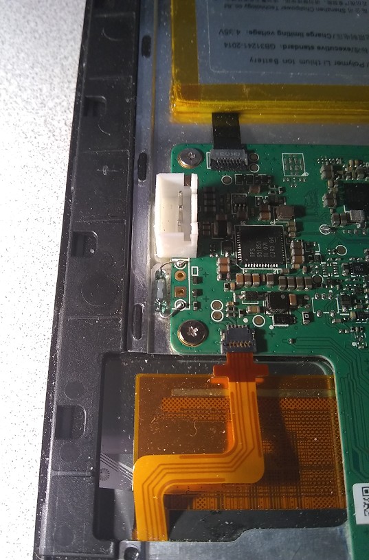

But what if you're the type that always gets into trouble and you hate opening the back of your device all the time?
Well, I put a little magnetic reed switch across the test points so that I won't have to open my device (Poke 3) ever.
It's specifically insensitive so that the magnetic book cover can't activate it.
You need to place a big magnet on the back of the cover and press the power button.
As a special offer and if you really think you will use this, PM me and I'll drop a reed switch in the mail for you.
I really can't imagine this applies to too many people; I only have a couple.
The white connector? Oh, that's the console UART.
It runs on 1.8V logic level, 115200-8-n-1
You'll need a level converter probably.
