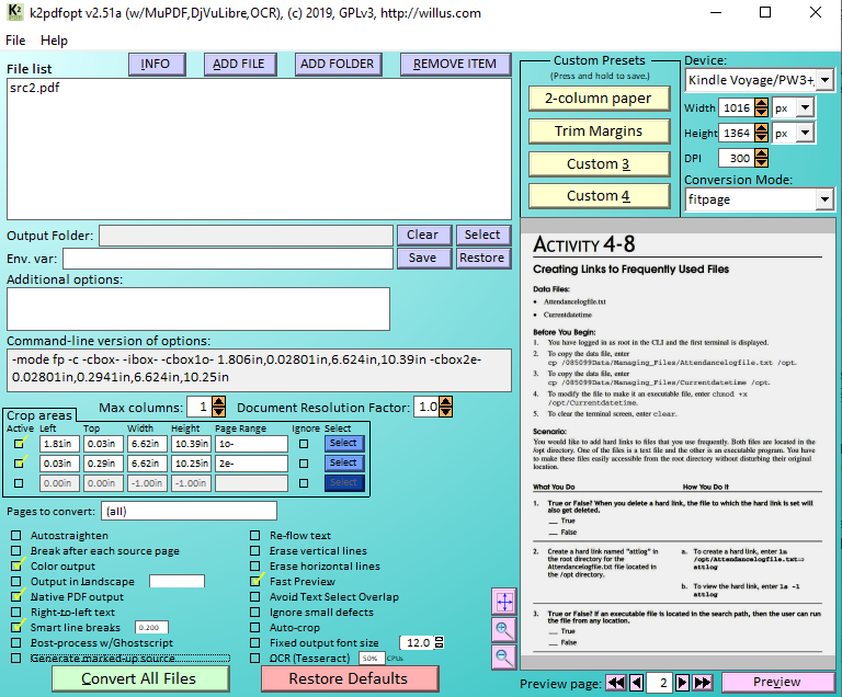

Originally Posted by Kule View Post
Hello again Willys,
I encountered issue with one book that has white margins every page (placed left on the odd pages, and right on the even pages).
I tried to crop these and to preserve page count, but no luck so far.
Here are the settings I used:
https://ibb.co/hK732gy
I sent you the source file on PM the following:
1) original PDF file (4 pages)
2) my converted result after additional tinkering with crop settings Adobe DC Pro (as it looks on the Sony DPT RP1).
To conclude, which settings should I use in order to stretch pages without any white margins on both sides (preferably to preserve original page count)?
Thanks for help
Sorry for taking so long to get back to you. Best bet is to crop out the footer and side margins of each page so that the cropped page fits your device better. I used one crop rectangle for odd pages and a different one for even pages. Then use the -mode fitpage (as you already figured out) so that you preserve the page count. See attached screenshot, marked source, and conversion file.
