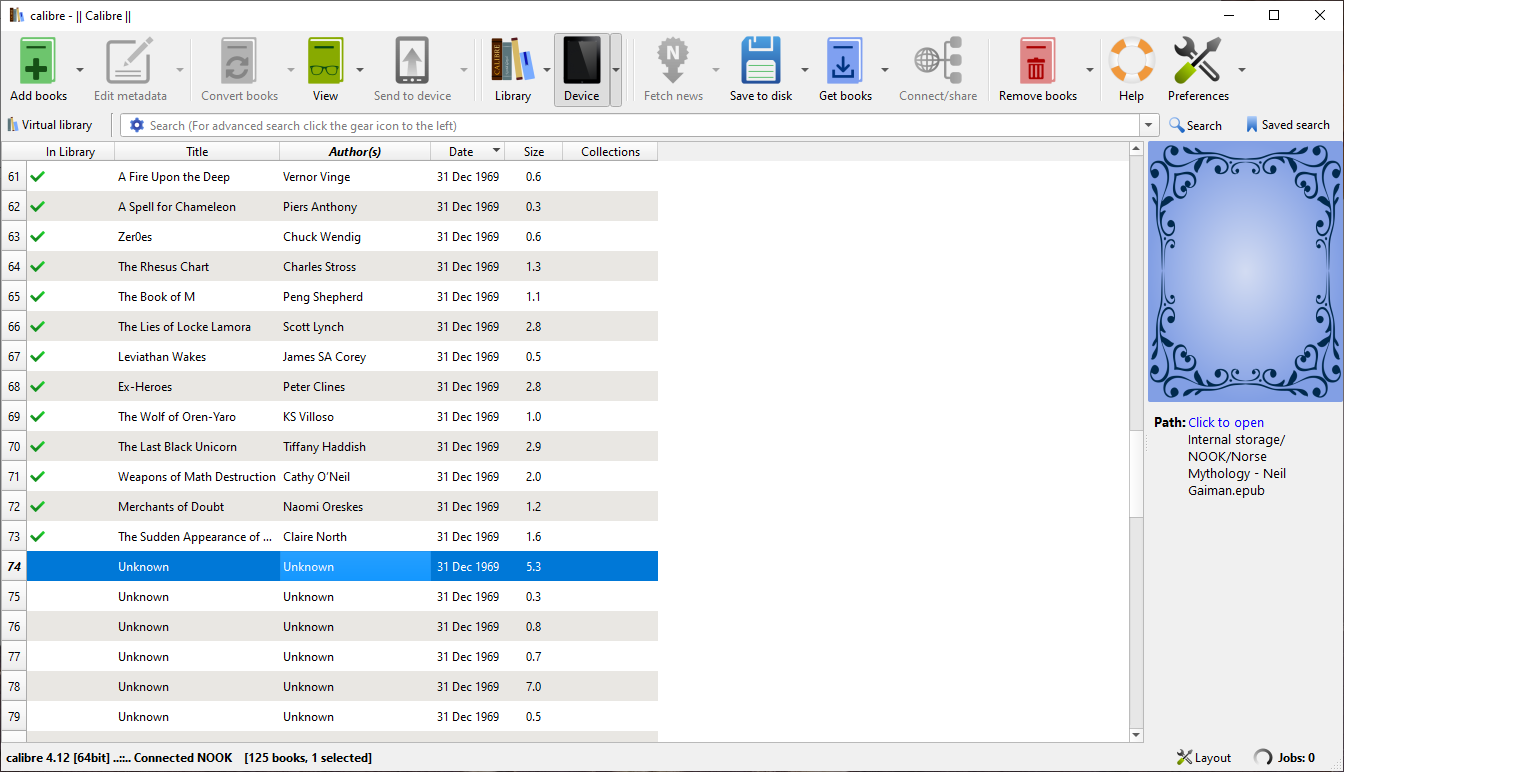

I've run into a strange error with my Glowlight. It's possible the problem started after I rooted it and I never loaded any more books to it until now.
The about page shows the model, serial number, app version (50.0.113/5.0.527), shop version (v5.0271), readouts version(v5.0.155) - not sure if any of that shows the root type.
Anyways, if I connect it empty, I can load any books I want, they all get check marks, they all show up if I switch over to the device tab. If I eject it and reconnect, about half of the books no longer have check marks, and in the device tab it lists a series of "Unknown/Unknown" books. When highlighted as in the image, it shows the file path, containing the name of the book (in this case Norse Mythology). If I click to open I get the following error:
calibre, version 4.12.0
ERROR: Error: Error communicating with device
Failed to fetch the file (u'Internal storage', u'NOOK', u'Norse Mythology - Neil Gaiman.epub') with error: Failed to read file from device: hr=2147942431 facility=7 error_code=31 description: A device attached to the system is not functioning.
File "site-packages\calibre\gui2\device.py", line 90, in run
File "site-packages\calibre\gui2\device.py", line 644, in _view_book
File "site-packages\calibre\devices\mtp\driver.py", line 328, in get_file
File "site-packages\calibre\devices\mtp\windows\driver.py", line 36, in check_thread
File "site-packages\calibre\devices\mtp\windows\driver.py", line 392, in get_mtp_file
DeviceError: Failed to fetch the file (u'Internal storage', u'NOOK', u'Norse Mythology - Neil Gaiman.epub') with error: Failed to read file from device: hr=2147942431 facility=7 error_code=31 description: A device attached to the system is not functioning.
If I click to open a book that is checked, it opens fine. If I disconnect and try to open "Norse Mythology" on the Nook itself, it opens fine.

I've tested multiple cables and USB ports, threw out one cable, and verified a combination that works fine with my (also rooted) Nook Simple Touch 100% of the time.
I've tried wiping all the books (including the Unknowns) from the Glowlight and loading new ones, and they show up fine until ejected and reconnected and we're back where we started.
If there's any other diagnostic info that would be helpful that I haven't found, let me know. This obviously isn't end-of-the-world stuff, because I can read them just fine, it just makes it tricky to change the collections as I read through them.
