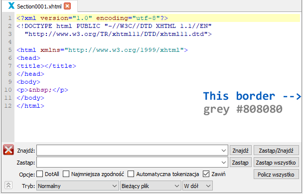

The gray frame around the main window is hardcoded and cannot be styled in any way by an external QSS file. Over the past year I have used Sigil without this frame and I don't miss it, but maybe in MacOS or Linux systems the frame matters.
The frame is defined in this way:
static const QString TAB_STYLE_SHEET = "#managerframe {border-top: 0px solid white;"
        "border-left: 1px solid gray;"
        "border-right: 1px solid gray;"
        "border-bottom: 1px solid gray;}";
It is easy to turn it off by commenting on the line that instructs you to turn on hair styling:
frame-> setStyleSheet (TAB_STYLE_SHEET);
The suggestion is to add a parameter with the example name SIGIL_DISABLE_BORDER_STYLING and then the main window would not be styled. Or – maybe – this frame is not so important. Then the interface is more like "flat" style.
Image: sigil-border.png
Image: sigil-dark-border-on.png
Image: sigil-dark-border-off.png

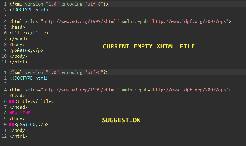

4. Default empty files – a layout more similar to that after mending
It's really a small thing.
Two extra spaces (in two places) and one new line.
Then the empty file before and after mending will be identical.
Separate change for epub2 and epub3.
Image: sigil-suggestion-4.png
