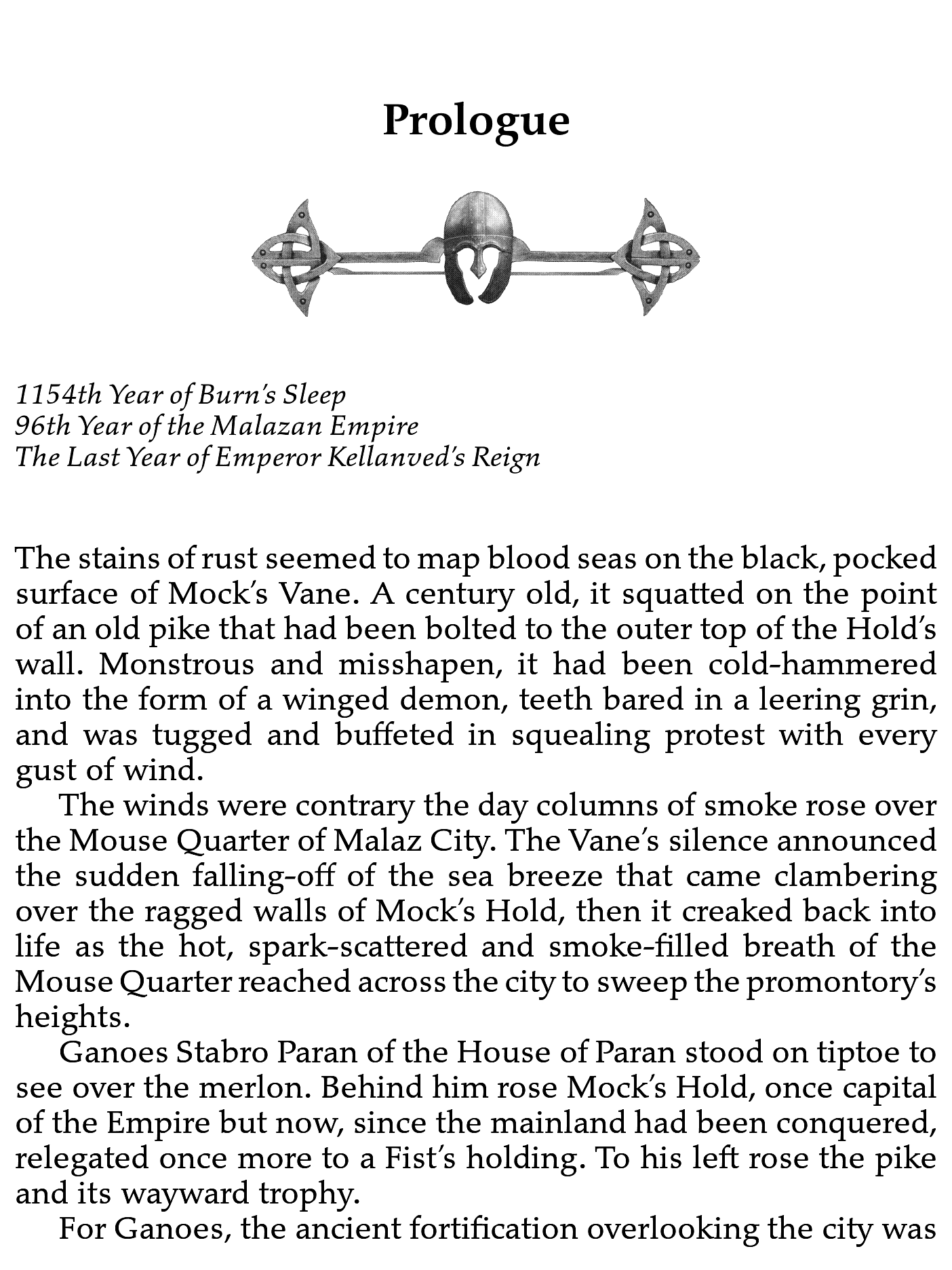

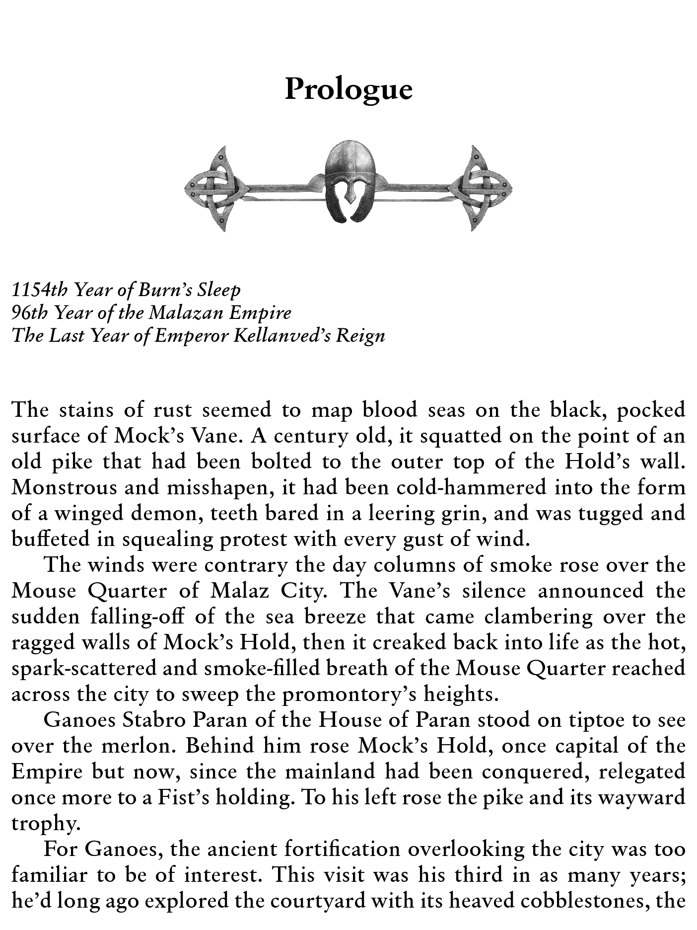

As an aside, I've included screenshots of all the eText fonts I have installed. In case you were thinking of, or still considering, getting any of them, you can see if they're worth it. One thing I can say, they look substantially... more substantial on the screenshots than on the device itself. Note that there are more fonts in the pack (like Amasis, Malabar, Caecillia, etc.), but they overlap with what comes default with Kobo, and there seems to be some interference there, so I can tell you nothing about them.
ID:	173767   Click image for larger version
ID:	173768   Click image for larger version
ID:	173769   Click image for larger version
ID:	173770   Click image for larger version
ID:	173771   Click image for larger version
ID:	173772   Click image for larger version
ID:	173773   Click image for larger version
ID:	173774   Click image for larger version
