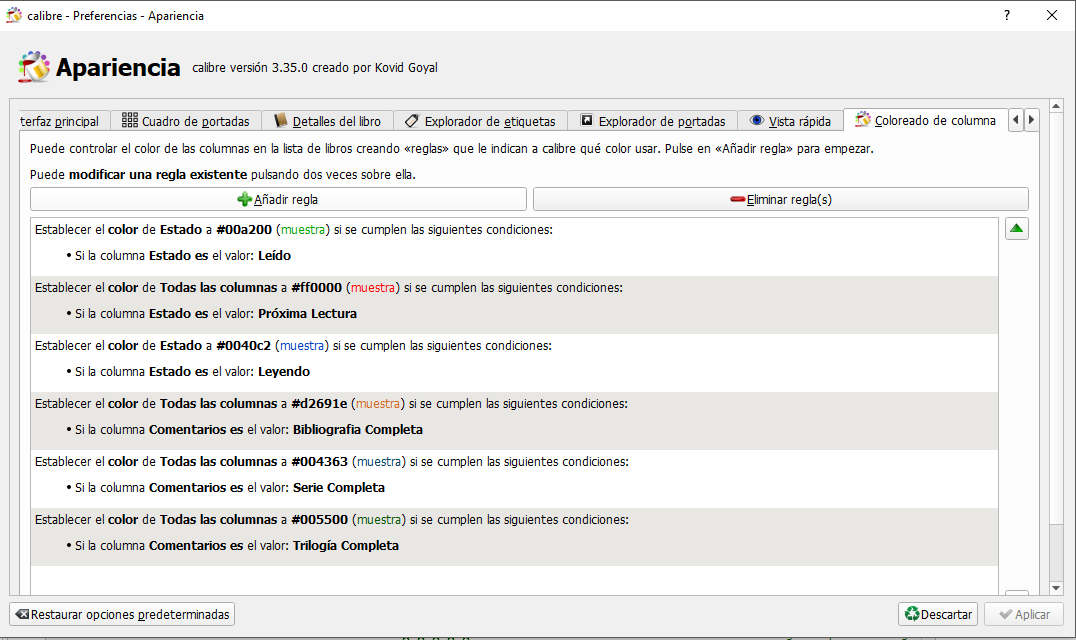

Yeah, that's using calibre's column colouring feature - my brain isn't very good at associating colours with a semantic states - apart from the state of my bank balance
Here's a sample of calibre's column icons feature from my test library
Attachment 168238
BetterRed here I leave you how to do it.
To begin we must go to the preferences button (it is in the top toolbar when it is displayed by pressing the arrows at the top right).
The next thing is to go to visual aspect.
And inside the colored tab of column you give to add rule.
-it dark green if the LEED value appears in the status column.
-it red title if the PROXIMA READURA value appears in the status column.
-Blue title and in the status column the value READING appears.
-author color chocolate if in the comments column appears the value Bibliografia completa.
Very important, do not forget to accept or do not keep it. And of course the green button to apply that in the image above is clearly seen. In the event that the rule created is not to your liking or does not work, you can modify it by pressing twice on it.
Considerations to take into account. When rules are created they are valid for the library in which they are created.
Well, I'm satisfied that at least it's useful to someone.
a greeting.
