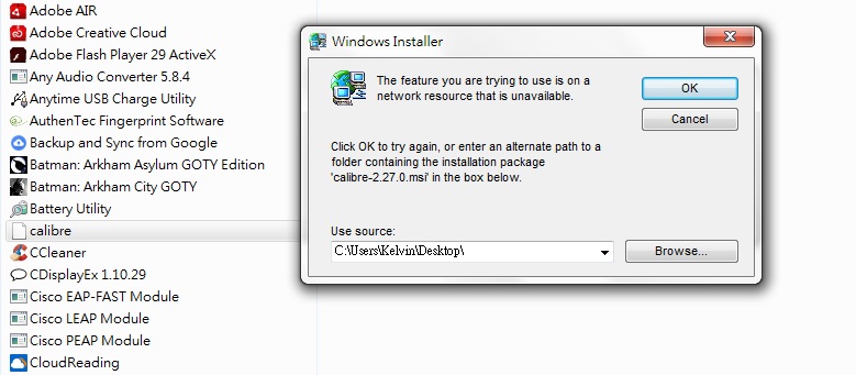

@kel.7 - if you are still having problems
  • if calibre (32bit and/or 64bit) appears in Control Panel->Programs and Features uninstall either or both;
  • if present, delete the Program Files/Calibre2 and Program Files (X86)/Calibre2 folders, and contents;
  • run a lightweight registry cleaner - here's some best free registry cleaner 2018 - watch out for extra bloat (e.g. CCleaner will offer Avast);
  • If you not interested in previous calibre customisations/settings etc, delete the C:\Users\pjd10\AppData\Roaming\calibre folder.
If all else fails install Portable Calibre.
Thanks for your advice. I tried it but the 'Calibre 2.27.0' still here and still can't delete it
