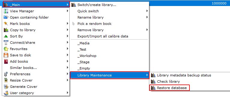

I reinstalled windows 10 on my SSD and kept all my ebooks on other 1 tera hard disk. I forgot that on my SSD there is my database stored and so I lost it. I used Calibre to recompose my metadata db but I realized that it did not restore my personalized column. How come ? because I though that my 3 personalized columns were store in the individual metadata file that is stored for each ebook on my tera hard disk. Can I recompose the database with these column ? are these column saved in my individual files ?
I assume by, "I used Calibre to recompose my metadata db but. . .", you're referring to this function.
If you mean something else, then can you explain exactly what you did.
Custom column definitions are stored in the library database, and the normal location for the library database is in the library folder, in a file named "metadata.db".
The only way I know of to relocate a library database anywhere other than in its library folder is via a symbolic link, which is a file system artefact. Could you confirm this (or something similar) is what you had.
Where did you keep the "metadata_db_prefs_backup.json" file, it is normally kept in the library folder alongside the metadata.db file. The Library Maintenance->Restore database function needs that file in order to restore custom column definitions. If you've 'lost' that file too, then that would explain why your custom columns are not being 'recomposed'.
