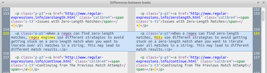

Oh, could it be that we talk at cross purposes. It's Edit book→F&R and Replace all→Differences between books, that marks the replacements (and the markings).
You could try selecting a completely different base Color scheme to see if it has a better contrast for marking.
I already come up with that idea - result negative, this means: same poor visibility all over.

I tried color theme wombat-dark

Differences between books (wombat-dark)
only for the reason here exists only 3 colors blue.

The wombat-dark experiments have shown it is DiffReplaceReplace / Background.
Color theme pyte-light DiffReplaceReplace / Background yellow
That was a pretty time consuming exercise - could end up totally frustrating, if it had turned out that the spezific color for replacements-markings in Differences between books is immutable.
