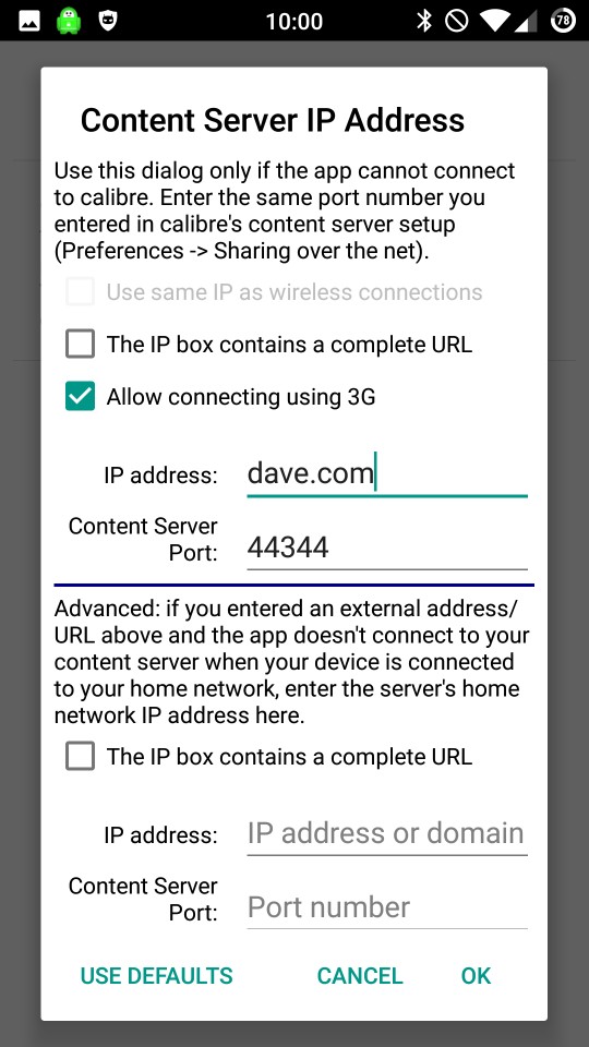

Hello,
I have a calibre server set up to run on (let's say) dave.com. It runs a very standard service from the basic setup tutorial, runs on port 8080, and its also password protected. For SSL I use STunnel from port 44344 so that if someone goes to https://dave.com:44344 they get the username/password prompt and can log in and use the server via HTTPS.
I would like to also get calibre companion to work with SSL/HTTPS.
I can get it to connect properly using http on port 8080 using the following configuration:
The issue is that nowhere in that configuration dialog can I find a setting for SSL, so as a result, I cannot figure out how to get it to recognize HTTPS, because this configuration:
produces the following upon my attempts to connect:
Any recommendations on how to make it work with SSL? Because I don't want to have to change my password after every time I connect over HTTP.
