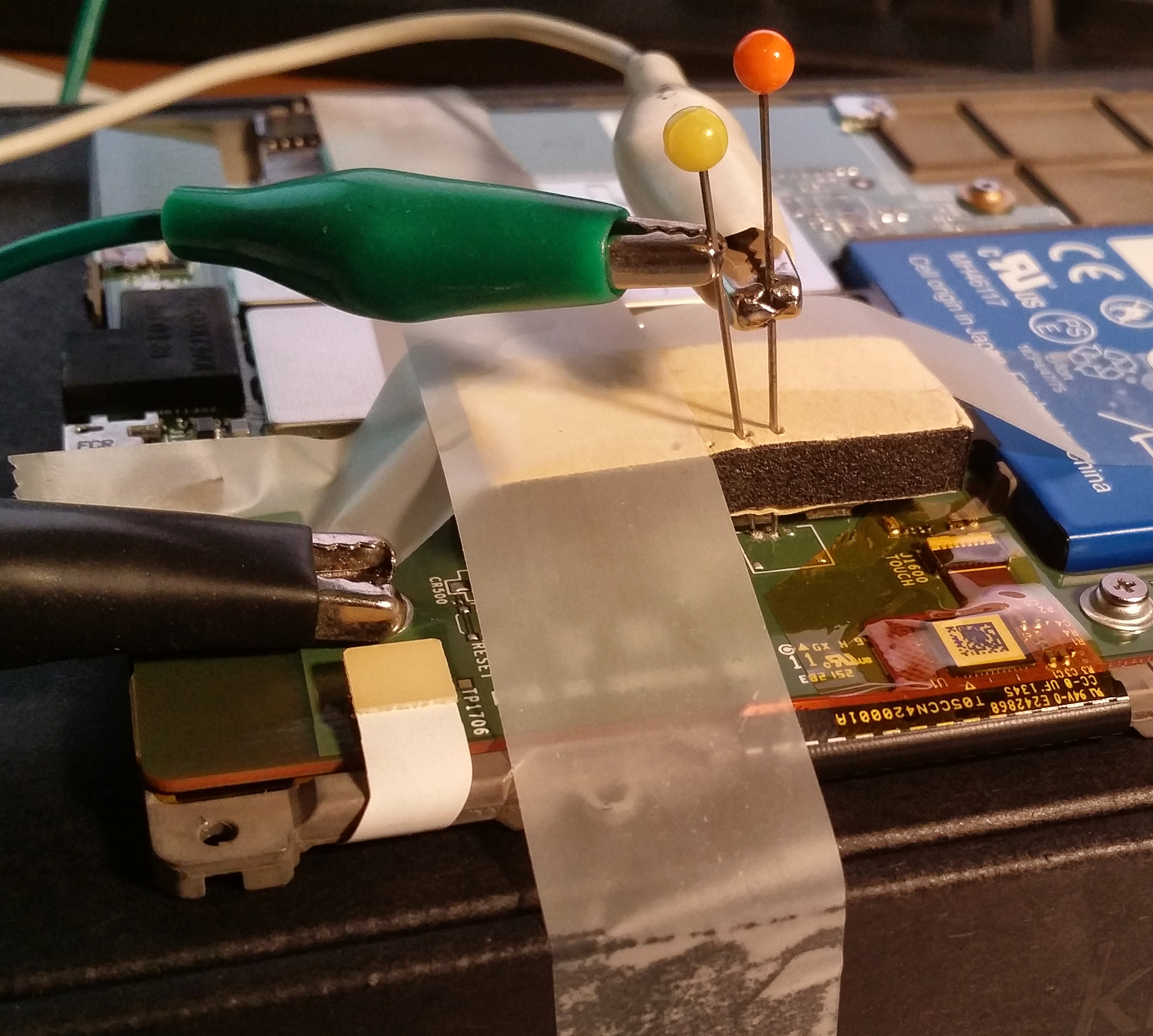

Back to the point of this post. I wasn't looking forward to wrestling with the soldering iron for my other PW2s so having realised I only needed two 'difficult' connections for tx and rx (earth connections are available in many places - eg, on metal covers, on screws, and solder pads) and that I only needed those connections for a couple of minutes I devised a simpler method which was OK for a temporary connection - see photos.
I simply sticky taped a piece of high density foam to the top of a cover next to the serial port pads and used the foam to support two sewing pins that are pushed through the foam and down onto the tx and rx pads. The big breakthrough was that when I raided my wife's sewing box I found both an orange and a yellow pin which happen to be the wire colours for rx and tx on the usb to serial cable! The pins push into the solder enough to make the connections more than good enough to do the job. It takes only a few minutes to get the jailbreak installed (note: the jailbreak was preloaded via the normal usb connection and the password was pre-caclulated using:

I don't know if it is a feature of the TTL-232RG cable or not but it helped only having to use three wires. The earth was easy as it was just clipped onto a screw head as in the photo. So it comes down to just getting two connections in place and that turns out to be very easy also.
I hope this helps someone else get the job done.
