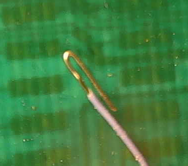

  • Photo #4
    One of the wire leads with a (sort-of) nice hairpin loop in the end.
    You can see the "bump" left from my first try to bend it, and then straighten it out again.
    The scale of things we are working with is the reason for the "forming tool".
    Just doing this with your fingers is possible, but can be tedious.
