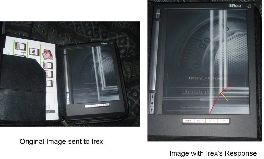

On November 19th, 2008, my Iliad developed vertical and horizontal stripes on the screen which prevents me from reading portions of documents and also accessing vital functions on the right lower corner of the screen. I purchased the Iliad sometime in May 2008 roughly 8months ago and have not really used it much. I sent an email with attached pictures of the screen to the Irex technical support for their review and advice and got a rather prompt but disappointing response from Irex Customer Support (Tom van Rijswijk). From the attached picture, Tom concluded that my Iliad had developed a crack in the mother glass and thus responded with the following comments:
“the display appears to be broken. There is a crack in the motherglass that starts at the bottom of the display and goes upward in a slight curve to the right. This type of accidental damage is not covered by our warranty and is caused by mechanical pressure being applied to the display. Replacement of the display module requires the purchase of 275 service credits in our webshop: https://www.irexshop.com/. After we have received your order, we will sent a return box to collect your iLiad and have it repaired.”
275 repair credits at $1.40 per credit comes to $385 for this repair which I am 100% certain is not the due to any mechanical damage. In my reply to Tom I questioned how Irex could have concluded that the display/mother glass was broken without physically examining the Iliad? I got another prompt response:
“the display still looks smooth from the topside, because the glassplate is covered by several plastic layers: the E-ink layer, a conductive sheet, a protective sheet and a layer of PET plastic. From our experience we can determine that the damage is actually a broken motherglass plate. The attached picture shows the cracks in red and a yellow arrow, that indicates the most likely point of impact, where the cracks originate from.
kind regards, Tom van Rijswijk”
I have been pretty happy with the Iliad until I had this problem with the device and experienced the frustration of not been able to talk to any tech support team and have to do this via email. Also Irex will not even take my Iliad until the payment of $385 is made. From reading previous posts on this and other blogs I am tempted to believe that this problem with “striations” developing on the Iliad screen is pretty routine and may be a result of faulty design. Initially I thought the device was still covered under manufacture’s warranty only to be told by Tom this was not the case with my particular situation. I am 100% certain that there was no physical impact to the device since I do not share my Iliad and always protect it in a padded bag (see attached picture). In addition I keep my Iliad and laptop in different compartments in a well padded laptop bag.
