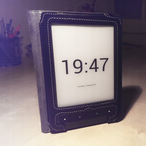

Hi,
I wanted to use my PB 626 with its long battery life and eink display as a simple night stand clock and didn't find anything usable.
There is Clocky available from http://fedorchenko.net/pb.php and the PocketBook free project website. It displays pretty terribly on my 626 though - half cut off.
I've based this on the clock sample code from the SDK 1.1, which did not start on my device due to missing resources in the current FW. I rewrote it to just use system fonts, display well and support all orientations. I intend to improve upon it and make it more modifiable and add an analog clock.
(Currently it will probably work well only with XGA (1024x768) screen devices, others will I believe break the text. I'll make it adjust properly when I get the time.)
So here it is, enjoy.

Tested on
  • PocketBook 626 Touch Lux 3, fw W626.5.5.720
Known issues
  • When started the clock is offset by some 70pxs. This gets fixed after the first refresh.
    This is because I put in a negative offset to deal with what seems to be a drawing bug in the SDK that offsets the canvas after the first refresh. Maybe I'll find out what causes it.
Current version 0.1
Next version
Done
  • Inverted mode (sexy)
  • Frontlight switch by touch (thanks brucelee)
Working on
  • Frontlight intensity setting via swiping
