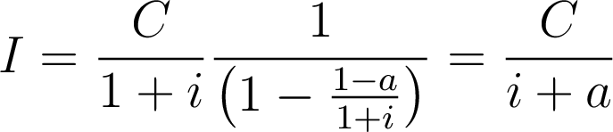

This is what I settled on, with the LaTeX used to get the formula in RED:
<div class="formula">
<div class="image"><img alt="\frac{\displaystyle\frac{\text{widgets} / \text{elapsed-time}}{[\text{widgets} \times (\text{elapsed-time})^{(\alpha-1)}] \cdot [\text{labor-hours} / \text{elapsed-time}]^\phi}}{[\text{labor-hours}]^{\alpha\theta} \cdot [\text{labor-effort}]^{\alpha(1-\theta)}}" src="../Images/QJAE8.4.4-pg055-Formula3a.png" /></div>
</div>
<div class="image"><img alt="I = \frac{C}{1+i}\frac{1}{\left(1-\frac{1-a}{1+i}\right)} = \frac{C}{i+a}" src="../Images/QJAE10.3.1-pg200-2.png" /></div>
</div>
