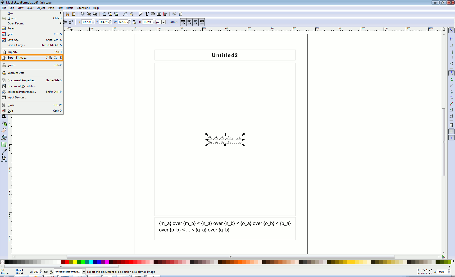

Make sure just the formula is selected and has arrows around it, and press File - Export Bitmap...
The Export Bitmap dialog should pop up. This is where you Inkscape what resolution the final PNG will be, and where to save the PNG.
IMPORTANT: Make sure along the top, that the "Selection" button is chosen. Selection means it will create a PNG of everything that is inside the "surrounding arrows".
Personally, I have settled on "320" as a good DPI for formulas. This determines how large the letters/numbers will be in the final PNG (and thus, the EPUB). Feel free to raise/lower this to suit your liking.
You can also manually tell Inkscape which X/Y resolution you want created by changing the "Width" and "Height".
Side Note: I recommend keeping the DPI the same throughout an entire book, so when formula PNGs are scaled to their max width, they will all have the same size font.
After setting the DPI (or Width/Height), press Export. This will now save the file to the location you selected.
Side Note: Inkscape auto-names the file g#####.png. This is quite annoying. Make sure you change to a better filename so you can keep the images organized.
Repeat Step 3 for all formulas until you have 320 DPI PNGs generated for all Formulas.

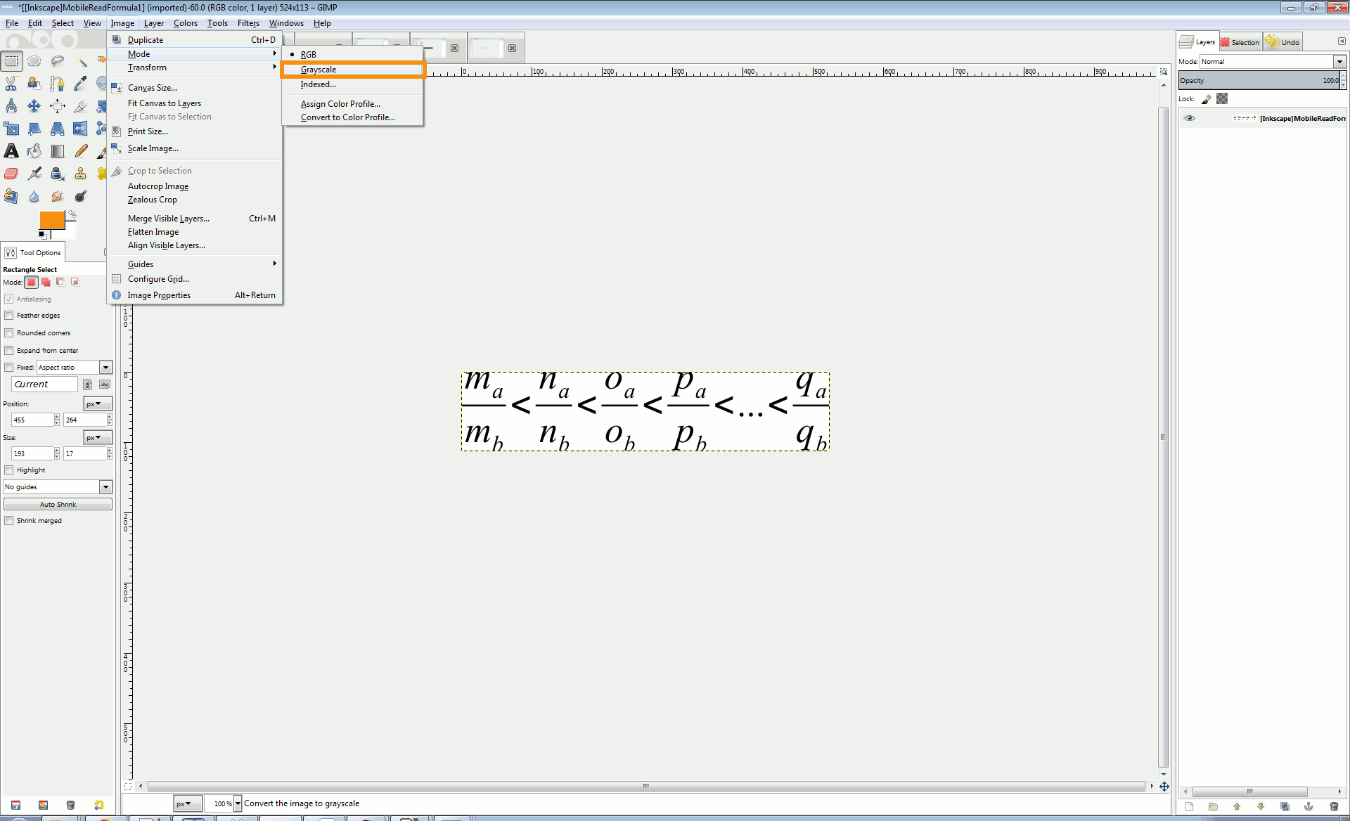

Since there is no color in this image, you want to change the mode from RGB to Grayscale.
Note: Going from RGB (nearly every color under the sun) to Grayscale will cut down the filesize DRAMATICALLY. "Grayscale" means it will be 256 shades of gray.
Press Image - Mode - Grayscale.
